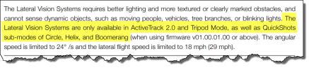

Here's a clip from my DJI User Manual...
There are certainly warnings about flying over water and the difficulty of the vertical positioning sensors being able to recognise height over water. There are no warnings about flying in the vicinity of glass clad buildings however
The worry about large expanses of glass is that obstacle avoidance can be fooled.
That wouldn't have been an issue as your drone never had GPS, so obstacle avoidance was unable to operate.
