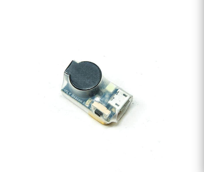

Consider one of these, you will get a flashing light (which you can see farther than reflective tape) and you will get a buzzer which you can hear from 10 times further away.
The OP is based in the UK so probably flying under the sub 250g rules. Adding anything (even some tape) let alone a 6g circuit board to a 249g drone is going to take him over the weight limit!
Reactions: Buel
That wouldn't necessarily bother me so appreciate the idea 😉
