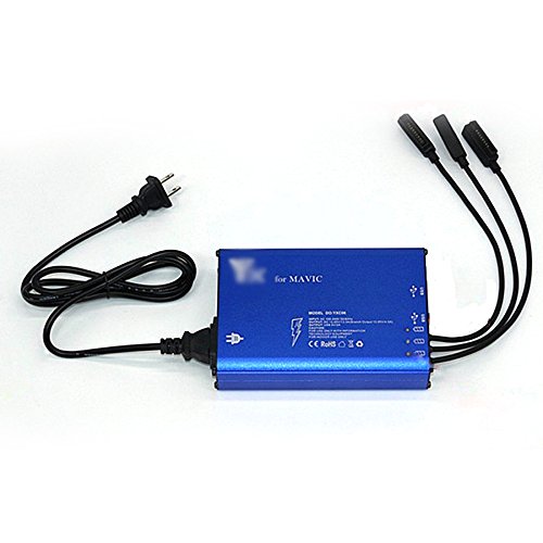

The fly more combo comes with a nice adapter that clips onto the battery connector and turns it into a USB power source with 2 ports. So you could use it to charge your phone, tablet or whatever runs off of 5VDC to drain off the battery as well. I have 5 batteries and I use one of them to recharge my tablet and RC at the same time and it only drops the battery about 15-20%. Also, there are aftermarket chargers on the market that folks are reporting good luck with. The isn't much concern since all of the charging control and protection circuitry is onboard the battery itself. So you just need to provide it with a 13.05VDC/ 4.3A source and the battery will take care of the rest. Below is a picture of tone of the more popular chargers you can find on Amazon or eBay etc....it can charge 3 batteries in parallel as well as 2 USB devices such as a phone/tablet and the remote.
