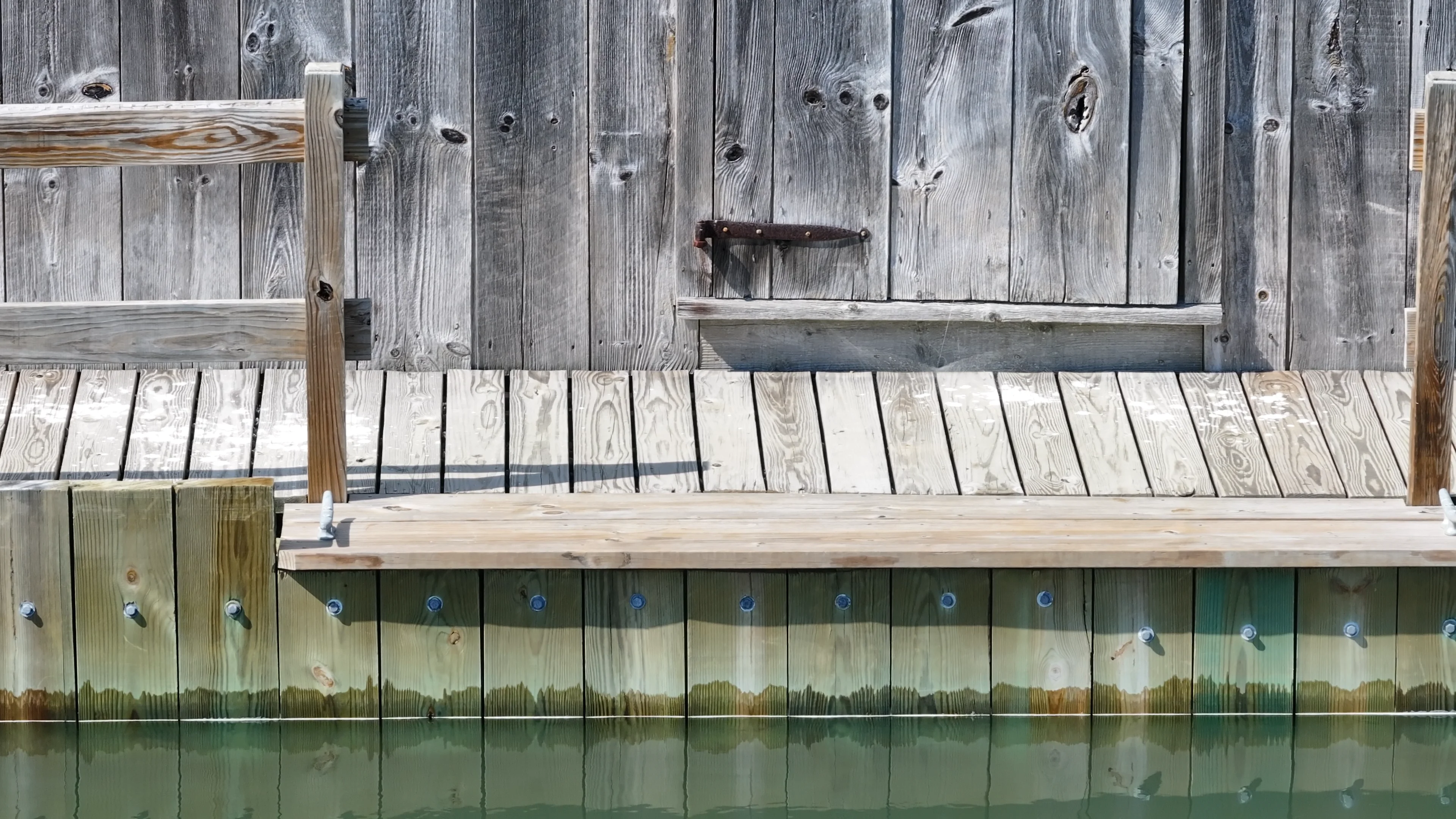

I have been having a very hard time removing a flicker from my 4k videos. It is especially noticeable on vertical white features, like a railings or trees.
It often occurs on a roof, with the roofing tiles causing a resonating wave as the drone pans across.
I've tried to shoot all manual, add an ND filter, reduce the shutter, change the exposure. Nothing solves it.
Has anyone found a way to remove this video glitch? If so, can you please share the settings that you used to shoot the footage.
Thanks!

Thanks for the input. There are no missing frames. It is a range of hot pixels, or white highlights where mostly seen. Like the edge of the roofing tile alternates between light and dark. The same with railings or trees with a sun facing side. The hottest spot flickers. For consistency, I often use the Circle QuickShot, which pans at set rate. I am not sure if I can alter that speed, but will investigate as an option. Personally, google's search results are biased. I prefer to turn to niche sites like this with kindred pilots since I trust their opinions more. Unfortunately, the dozen posts on the topic did not really solve the issue for me. While, attempting to fix it in Post is always an option to explore, my 'go to' NLE, Videostudio, does not have the advanced features as Premiere. So I'm hoping there's an ideal combination of settings that can minimize the effect in camera.
