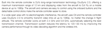

The Air 2S uses the exact controller as the Air 2. They both have 2 antennas. The drone itself has 4 antennas.
I saw this on a different forum. Please see the attached pictures, discussion with a pilot & DJI rep.
I guess I’ll reach out to DJI myself to see what’s what. Thanks for the info.

The DJI support agents are worthless for things like this, but feel free to see what they say.
It is the same exact model number with the same exact markings. DJI would have differentiated it if it was actually different. Plus, from the actual Air 2S manual:

I'm pretty new here. I just got my first DJI, the Air 2S. I also bought the smart controller. I had a chat with DJI online support and I was told that the SC would have a lower range than the stock controller that came with the A2s. So I set up a return for the SC. Support specifically said that using the SC would lower range and transmission rate to Occusync 2.0 where the stock controller uses Occusync 3. Now I see posts saying the stock controller also uses Occusync 2. Has anyone confirmed this? This contradicts what I was told by support.
It can't be said enough....those support people are worthless when it comes to technical details and questions. Actually, less than worthless because instead of saying "I don't know" they seem to make things up.
Two important facts for you:
1 - The stock controller is Ocusync 2.0. Documented by DJI and is the same controller used by the Air 2 and Mini 2 before O3 even was a "thing". Unless DJI's documentation is wrong (which is possible, but less likely than the support agent), this should be true.
2 - People have been getting less range with the Smart Controller. That's not an Ocusync 2 versus 3 thing. It happened with the Air 2 as well, which is all 2.0.
So, no the version of Ocusync is not different, but yes it is entirely possible your will lose some range. If that range loss is significant enough for you to care about, only you can answer.
Reactions: TheRock
So when both available controllers (stock, SC) for the Air 2s only support Ocusync 2 what is Ocusync 3 needed for at the moment?
The drone itself has extra antennas. Perhaps (just a guess) better algorithms. I think I've posted this in half the threads in this forum already, but one more time----from the manual:
