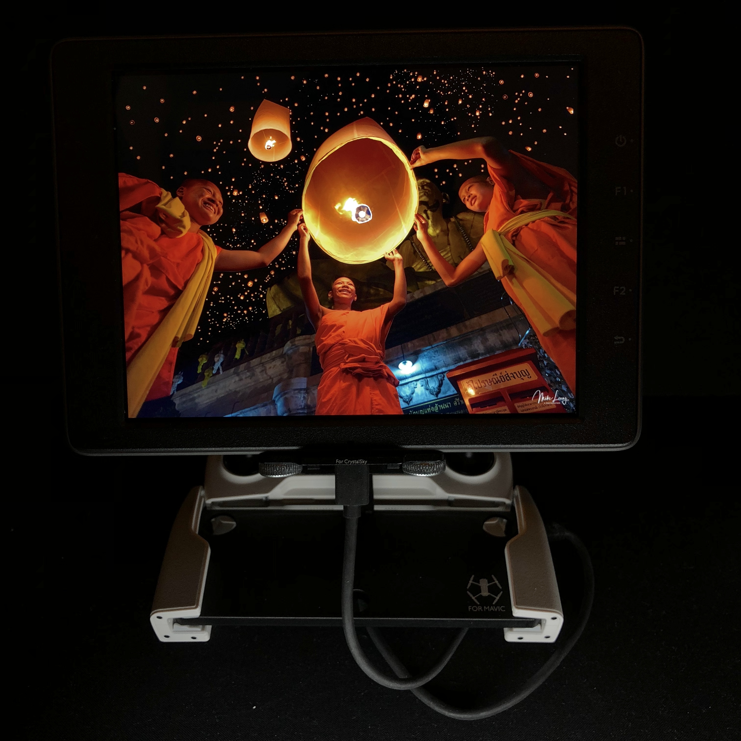

Yeah, I tried a right angle cable and like others have said it didn't do much. I finally took the MavMount off the base plate and just used the aluminum plate with a DJI mount for the Phantom bolted to the plate. Now I can use a lanyard without interference.

En expensive plate. :-) But i do fully understand.
Making the lanyard ring bigger/longer would help a lot. But thats not up to me but to the developer.
Peter
I'm hoping he makes a proper mavmount base plate that accepts the DJI quick release bracket - this would be the ideal solution and I'd buy one in the blink of an eye :D

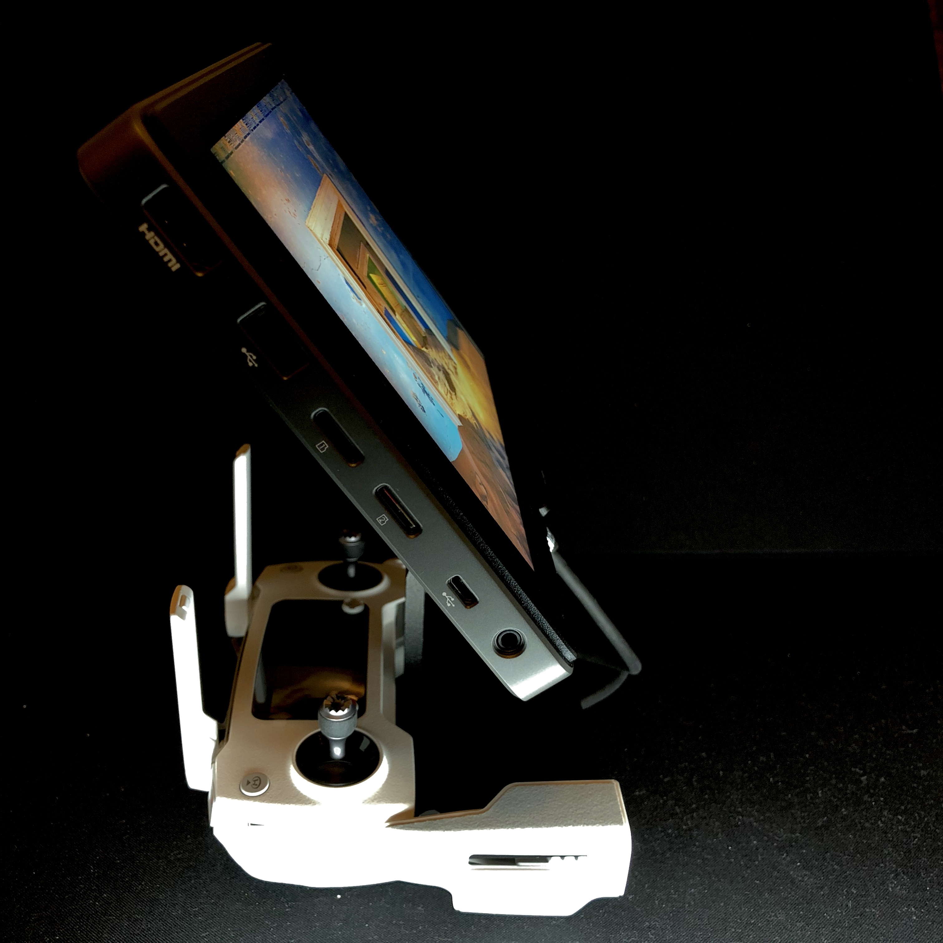

1.jpg 2.jpg 3.jpg 4.jpg 1.jpg 2.jpg 3.jpg 4.jpg I have a CS Ultra 7.8 and its wonderful.. glad I did that purchase ! Now my delma was I need to use it
for both Mavic and P4P, with the OEM bracket on the bottom of the CS, So I cam up with this and now I can
use my CS 7.8 on both birds and heck maybe even my Spark :) . I had an extra Mavmout so I have it all set.
used all the mavic hardware and the mavmount hardware , and placed the neck strap holder on there now to just tak it in place and DONE !
It balances very well like this... I don't like the balance the way CS want to have it mounted on the Mavic controller below way to heavy
that way... anyways this is my idea. just thought I would share it. oh and then I had a short 4 inch male to female USB cable for the reach, not sure why there is double photos and there side ways

Is the DJI mount bolted (I think clamped) or glued the ball head ? bit hard to see
I couldn't afford to drop the Ultra
It is clamped with the mavmount large round nut then JB welded to the CS bottom bracket and it does not move one bit VERY strong.
You can still tilt it forwards and backwards for your viewing angle. I will try and take a pic closer to that area.
the only thing you would need is the JB weld of course and a 4 inch USB male to female cable that I found
on eBay. I feel the same way. no way I am going to drop this CS Ultra as well. this fixes my problem of using it
on multiple controllers as well.
OK, here is 3 photos, front back and without the top added , my JB weld ran a little bit but boy you can not break it apart.
The mavmont spin on round bolt thing clamps on first and holds it perfect with the right amount of space , then JB weld it.
