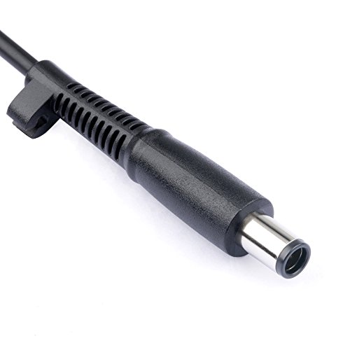

Hi, since I have a mavic pro and I wish to buy the 5.5" crystalsky, what's the best charger that I can use?
Is there a charger that I can charge the monitor and I can also use it with mavic or charge some other mavic accessories?
Thanks
You have to get a charger which has the barrel plug. You can either get one of the DJI Phantom 3, 4, Inspire 1, 2 or a 3rd party charger. It has to have a barrel plug. There aren't any chargers that simultaneously work with Mavic/Mavic accessories and CrystalSky.
I bought the 100W Phantom 4 charger. I use the barrel attachment to charge the Crystal Sky battery and use the other end to hook up to my Mavic Advanced charging hub to charge the Mavic batteries. You cannot charge both at the same time but the 100W charger on the Mavic battery advanced charging hub ($55 ) really cuts down the time it takes to charge 4 batteries.

I did the same thing as Stan1915. It is a good setup and still reasonably compact.

I ended up buying the p4 car charger for my CS ...
