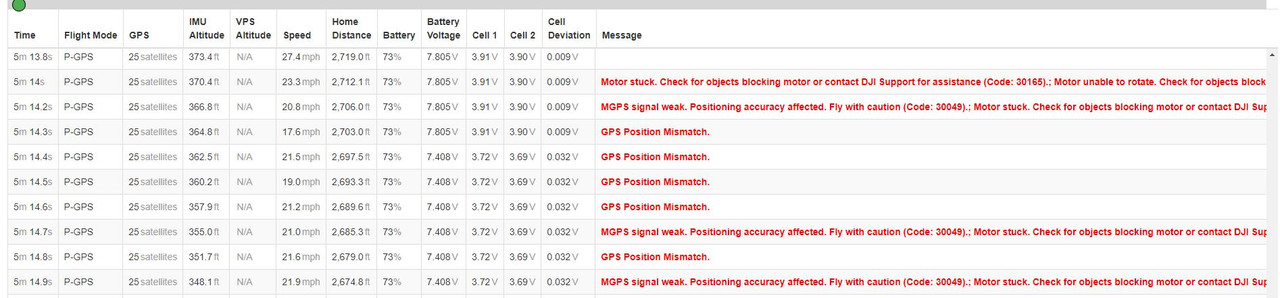

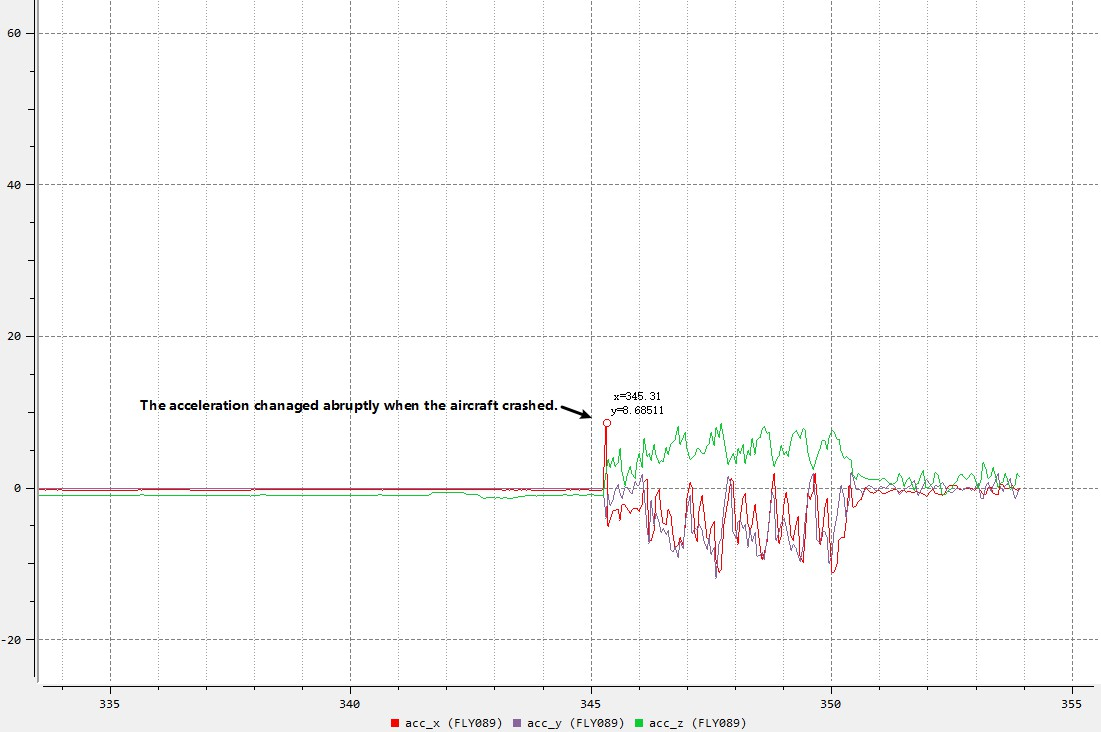

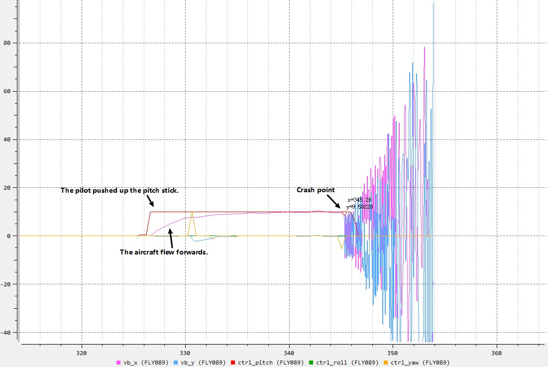

I was flying with my mini 2 at 100+m altitude when i got an error: "motor stuck".
Drone started rotating and crashed pretty hard.

If the drone is intact enough their are logs on the drone that DJI should be able to access, I have the impression they are reasonably fair about taking the blame if it proves to be a warranty matter.
Did you send them the .txt and DAT from the screen device, do you still have a copy of those logs.
It looks like you have uploaded the .txt to Phantomhelp, can you post the URL to the log here?

I got an detailed explanation of what happened and unfortunatelly its the bird that attacked the drone.
Reapair cost is 110 Euros.
