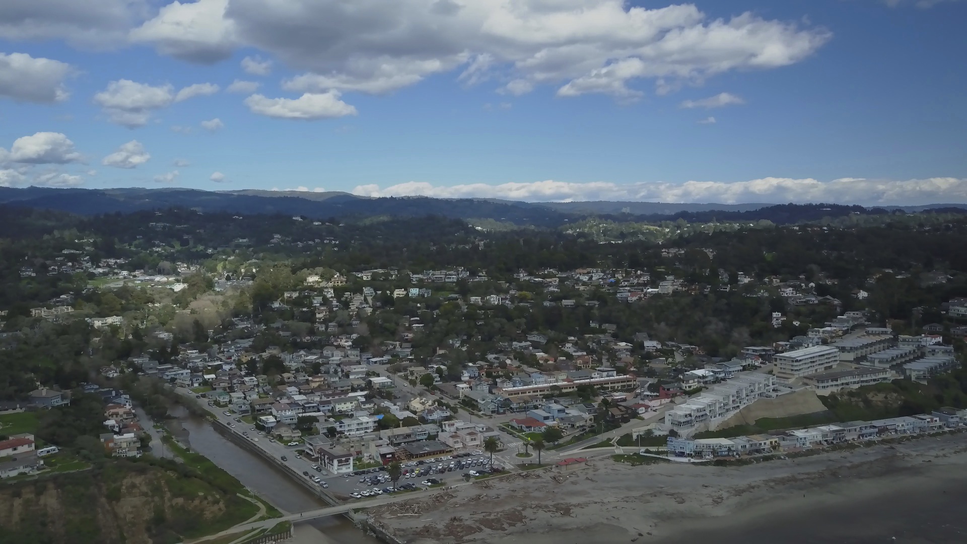

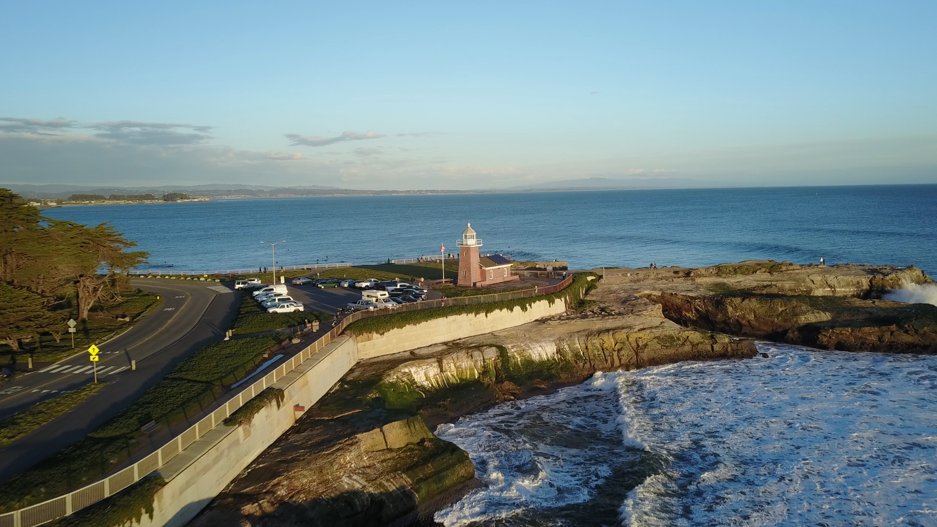

Attached are two photos, the first when I still had watercolor, and the 2nd which appears much better. These are screenshots from 4K video. The first was in D-cinelike, and the second is with color profile None.
