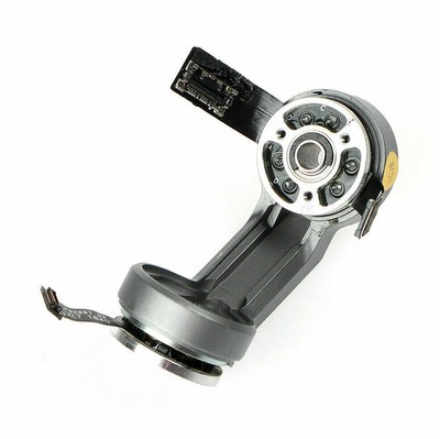

Now i just need suggestions on fixing the unmoveable gimbal. I did get almost constant "gimbal motor overload" & "gimbal obstruction" errors. Anyone that's versed in repairs think replacing the motor arms will help?screen_e8597ae955026ed0_1565399322000.jpg
Send it in for repair, you have either damaged the gimbal motor signal wire or even a motor itself but the Mavic 2 gimbal is not one to be repaired by the home handy tech. It's very complicated and precise bit of kit that is not to be messed around with. DJI have made it very difficult to disassemble and repair.
I've already had the gimbal removed. If i send it in I'm going to ve paying another $300.

So, AliExpress sellers have all parts for those gimbals, but if you never soldered micro electronics it may not end well. Brand new zoom gimbal used to cost around $270 or so, can be more now.
