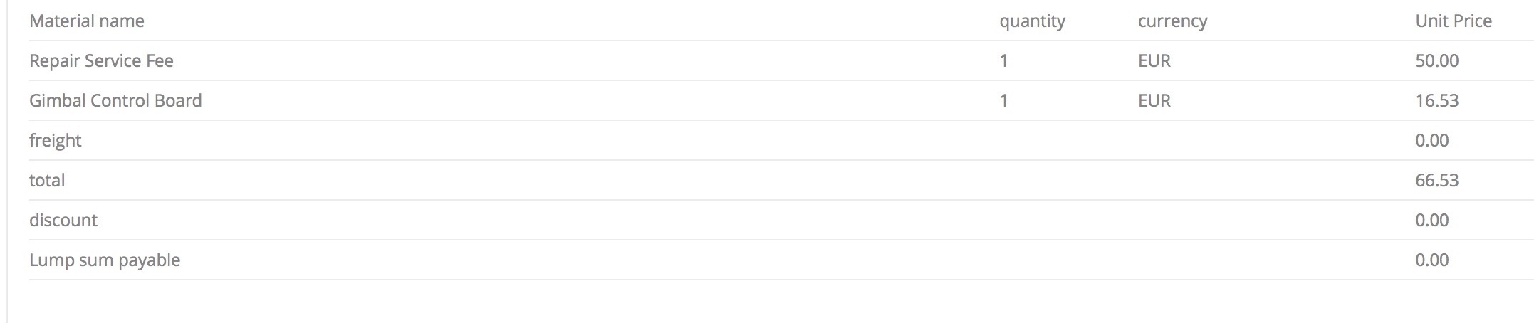

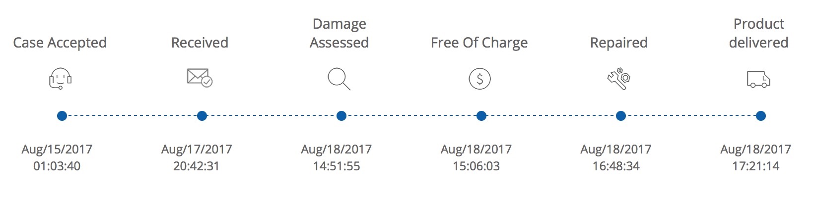

Today's update:
Repair completed very soon. They changed the gimbal control board as I saw in the invoice.
Mavic is on warranty so I didn't pay anything.
See these pics:
I have to say that in my case their support was excellent. Until now of course. Still waiting the mavic to see if it is working fine. But their did the work the same day. They received the aircraft and the day after they repaired and shipped with no delays.
I've heard that their support isn't good enough. In my case I have to say it again was excellent.
I will update when I receive the aircraft next Wednesday.
