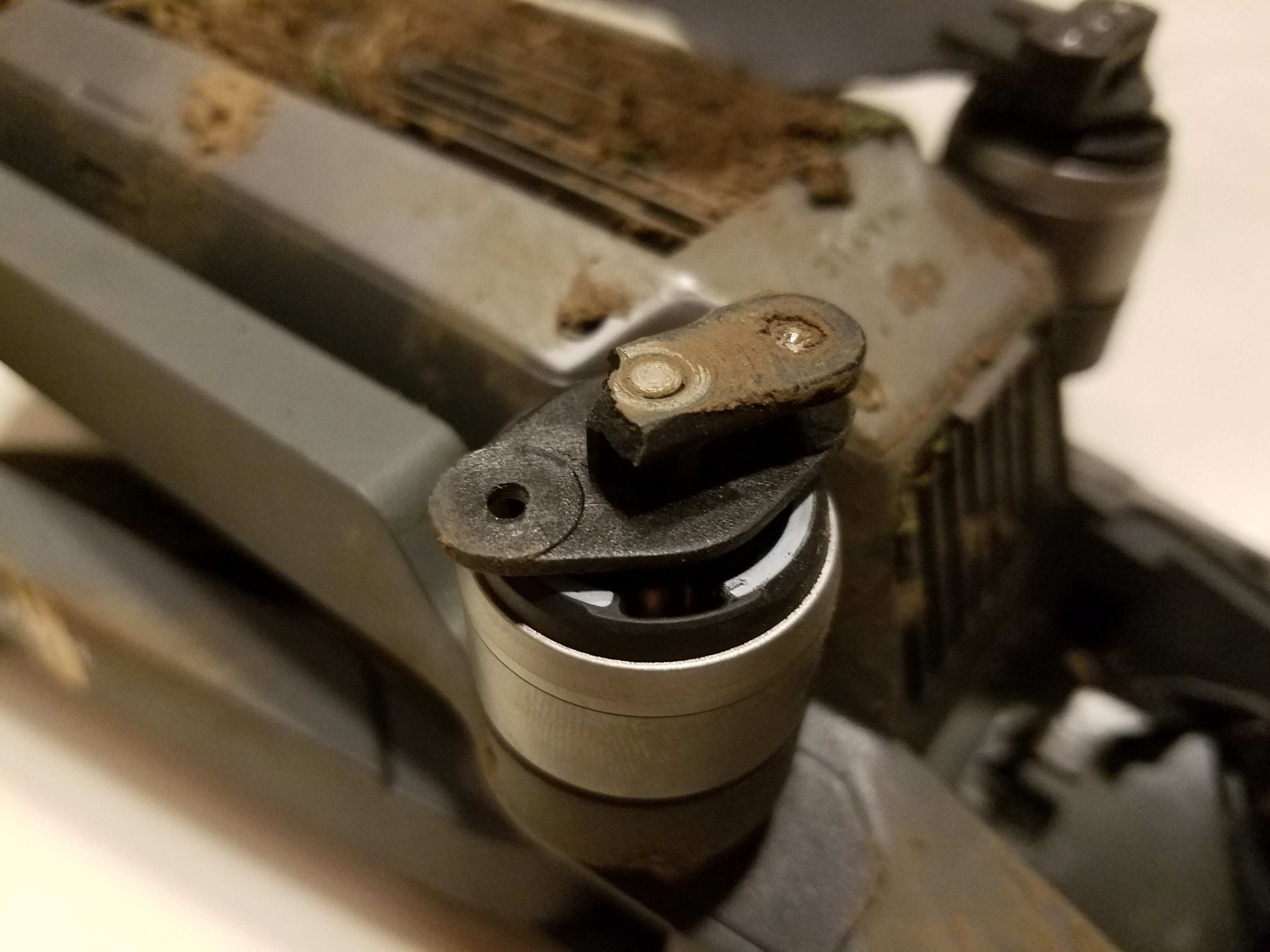

This is what's left of the one missing prop, which I could not find at the crash site. Hub still attached to the motor.
Prop failure almost certainly...triggered for whatever reason by the additional load as it engaged in Sport mode.
The others are intact and unbroken.
Reactions: WAXMAN

The .txt shows Sport starting at 118 secs. And, then the .DAT shows what appears to be a leftBack prop failure at 118.712 secs (about 0.7 secs after Sport mode was initiated). The leftBack speed increases in an attempt to produce more thrust from the failed prop. Concurrently, the rightFront speed decreases to match the lower thrust from the leftBack prop.
The CCW rotation that then occurred is consistent with prop loss on either the leftBack or rightFront
AFAIK, there hasn't been another incident where a prop failure immediately followed a switch to Sport mode. Maybe the prop was damaged to begin with.
The .txt shows Sport starting at 118 secs. And, then the .DAT shows what appears to be a leftBack prop failure at 118.712 secs (about 0.7 secs after Sport mode was initiated). The leftBack speed increases in an attempt to produce more thrust from the failed prop. Concurrently, the rightFront speed decreases to match the lower thrust from the leftBack prop....
AFAIK there hasn't been another incident where a prop failure immediately followed a switch to Sport mode. Maybe the prop was damaged to begin with.
Thanks Bud. At least I know I didn't do anything terribly wrong to deserve this, and I know for future reference that I need to be meticulous about checking the prop hubs (that's where it failed). Maybe replacing them every 15-20 flights or so wouldn't be a bad idea anyway considering the cost of repairing the whole Mavic.
