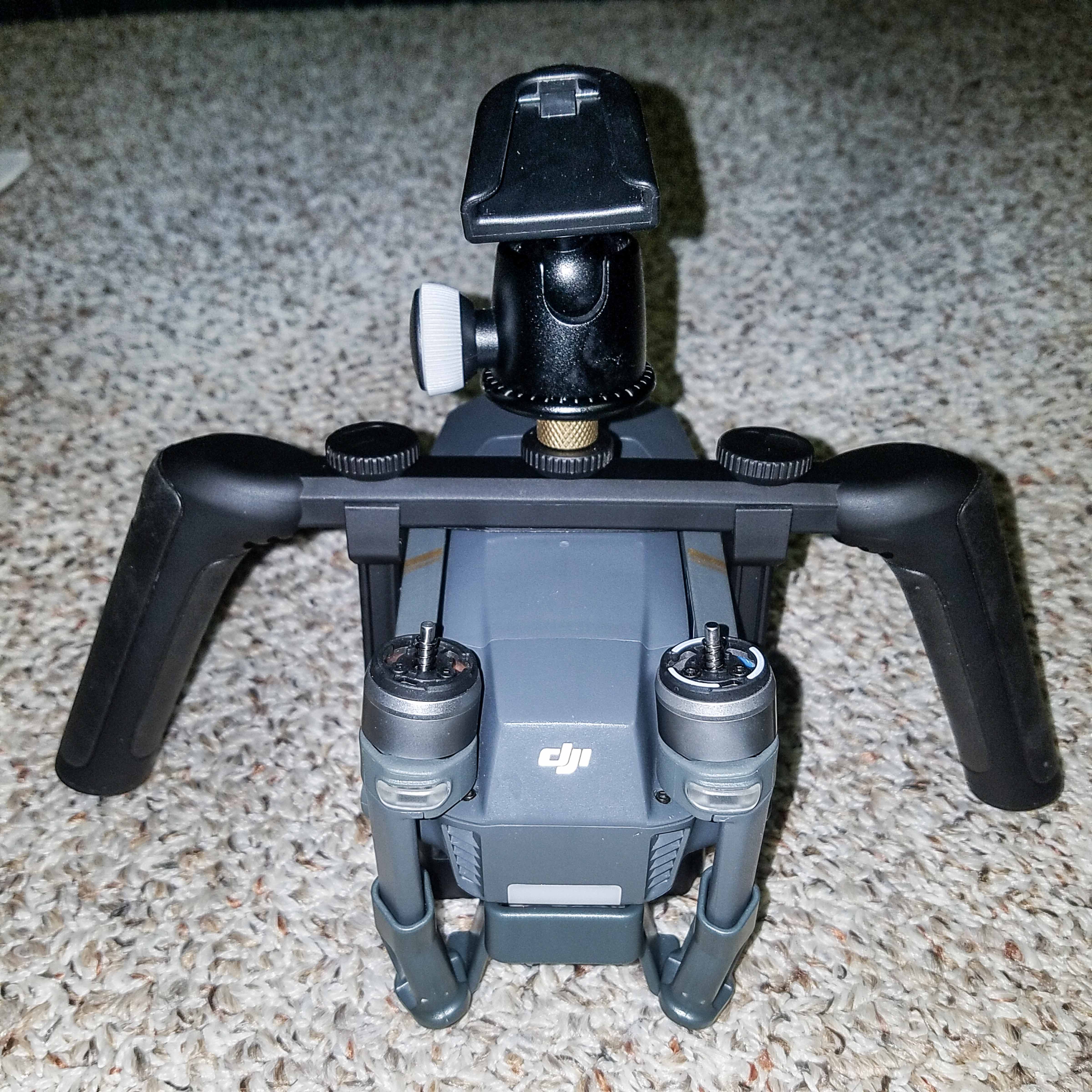

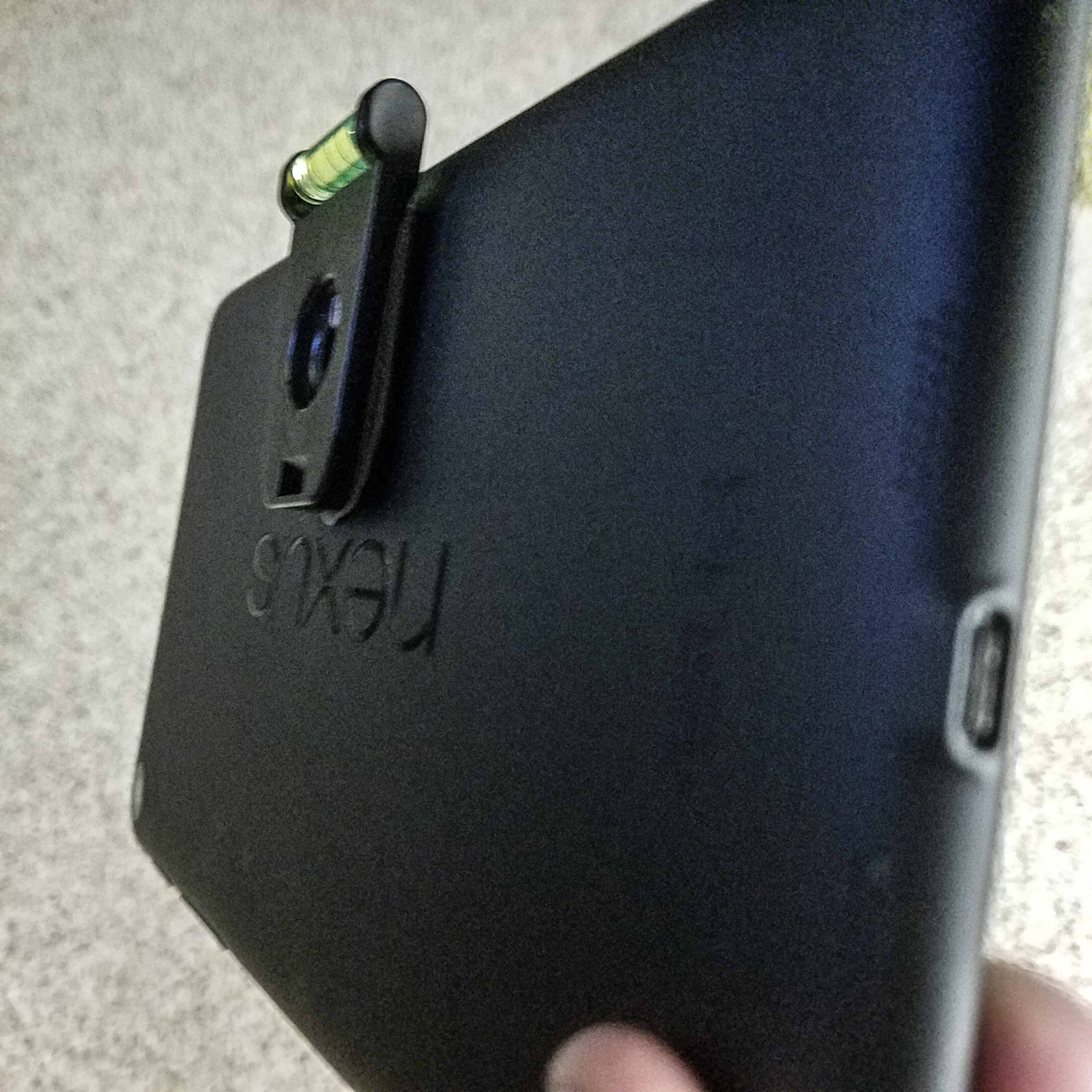

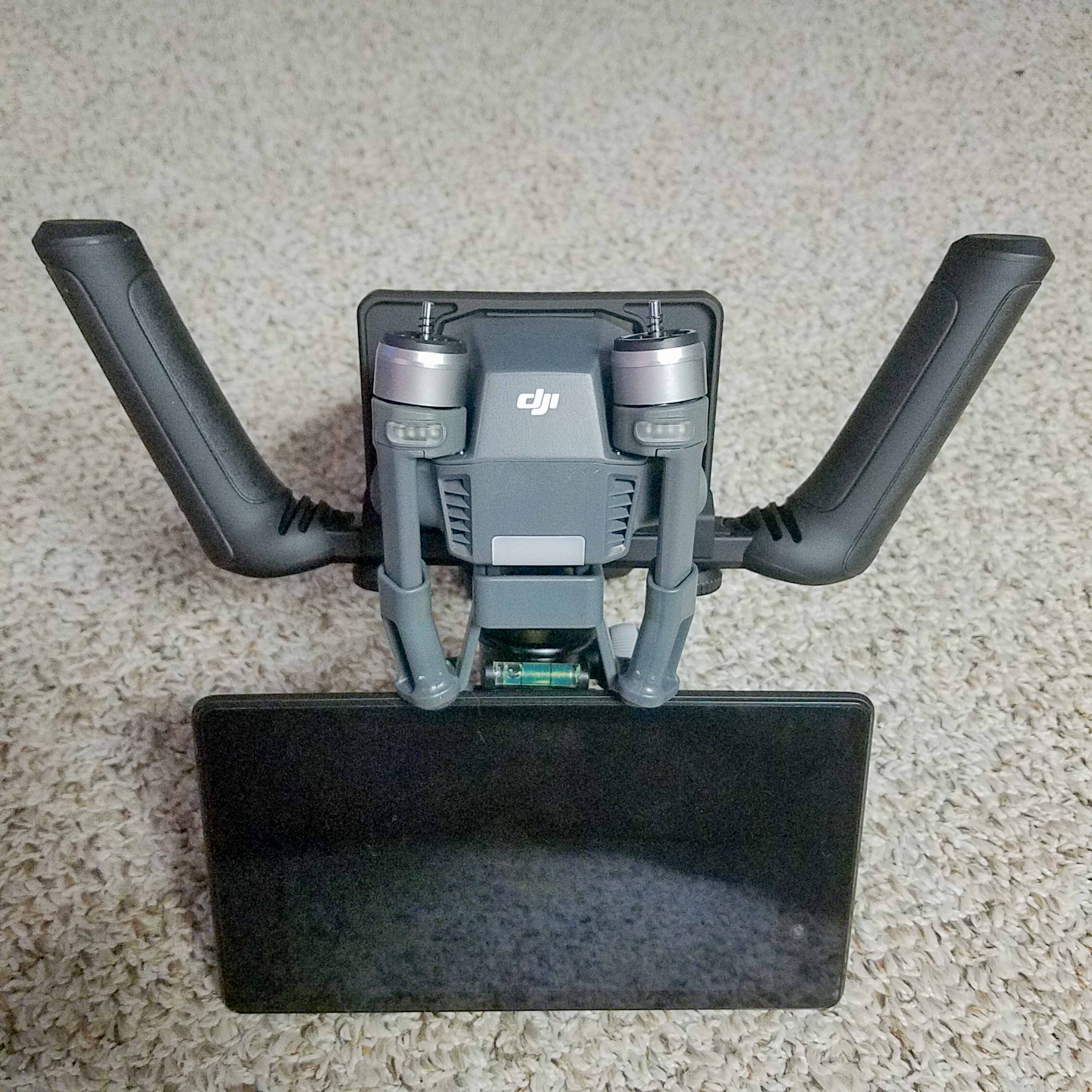

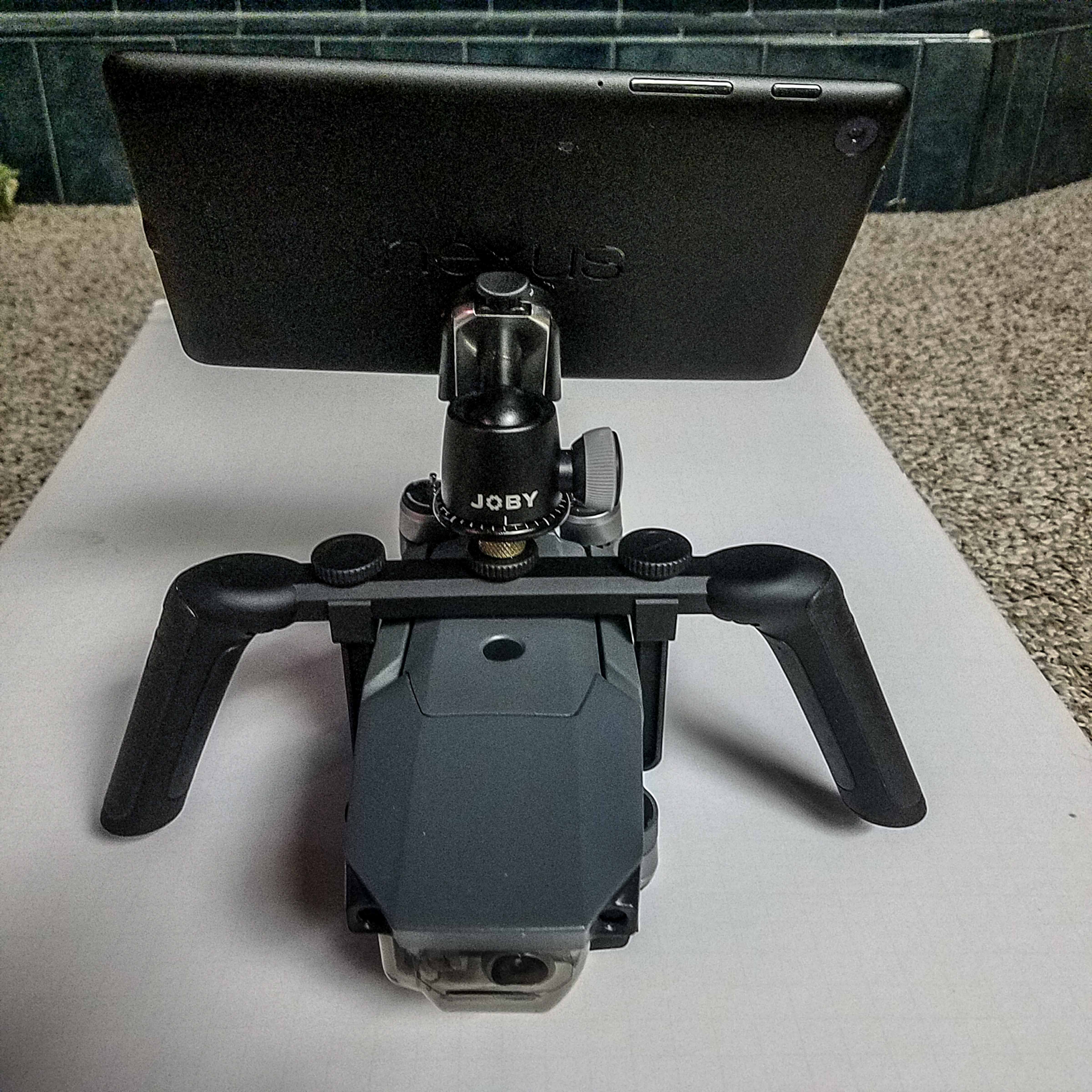

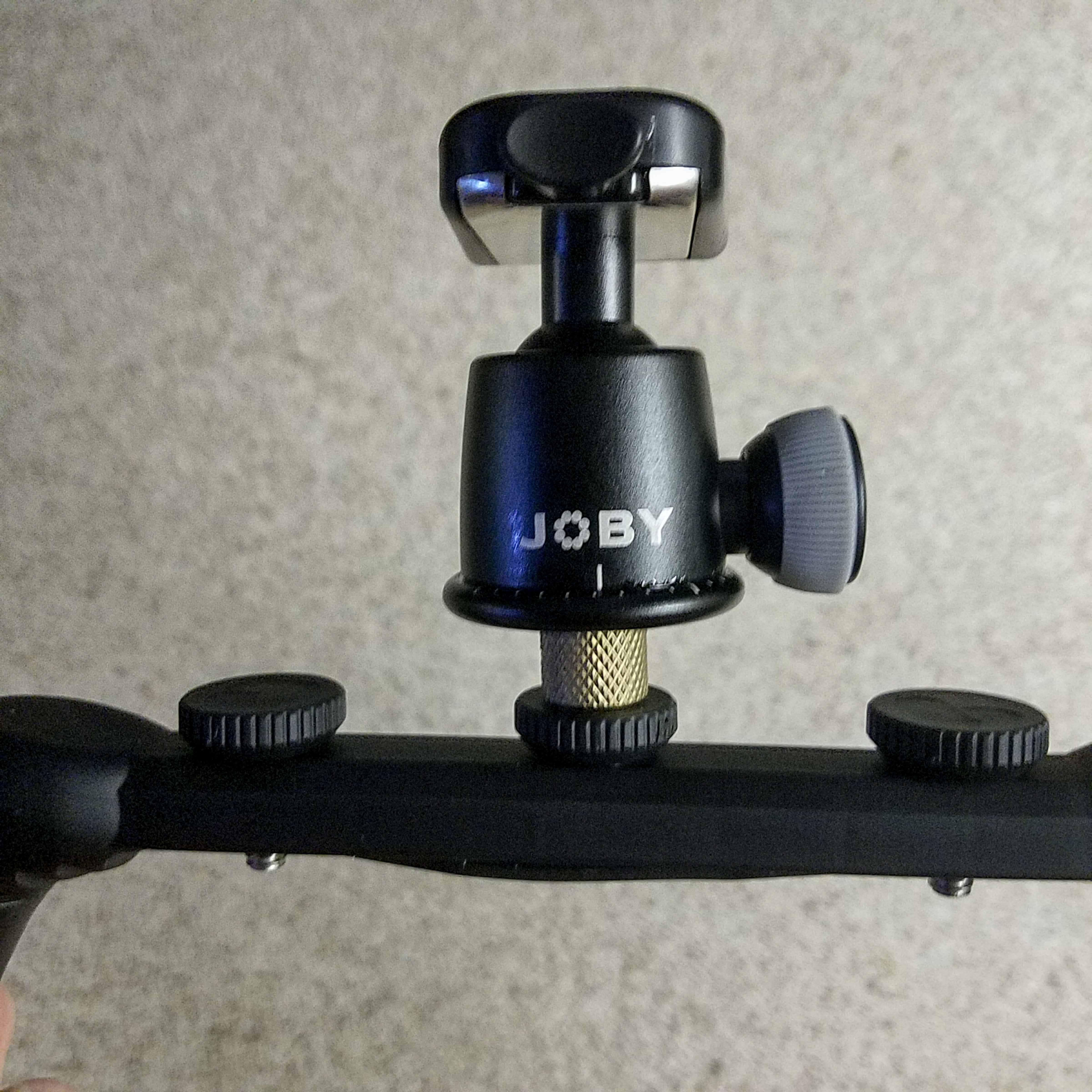

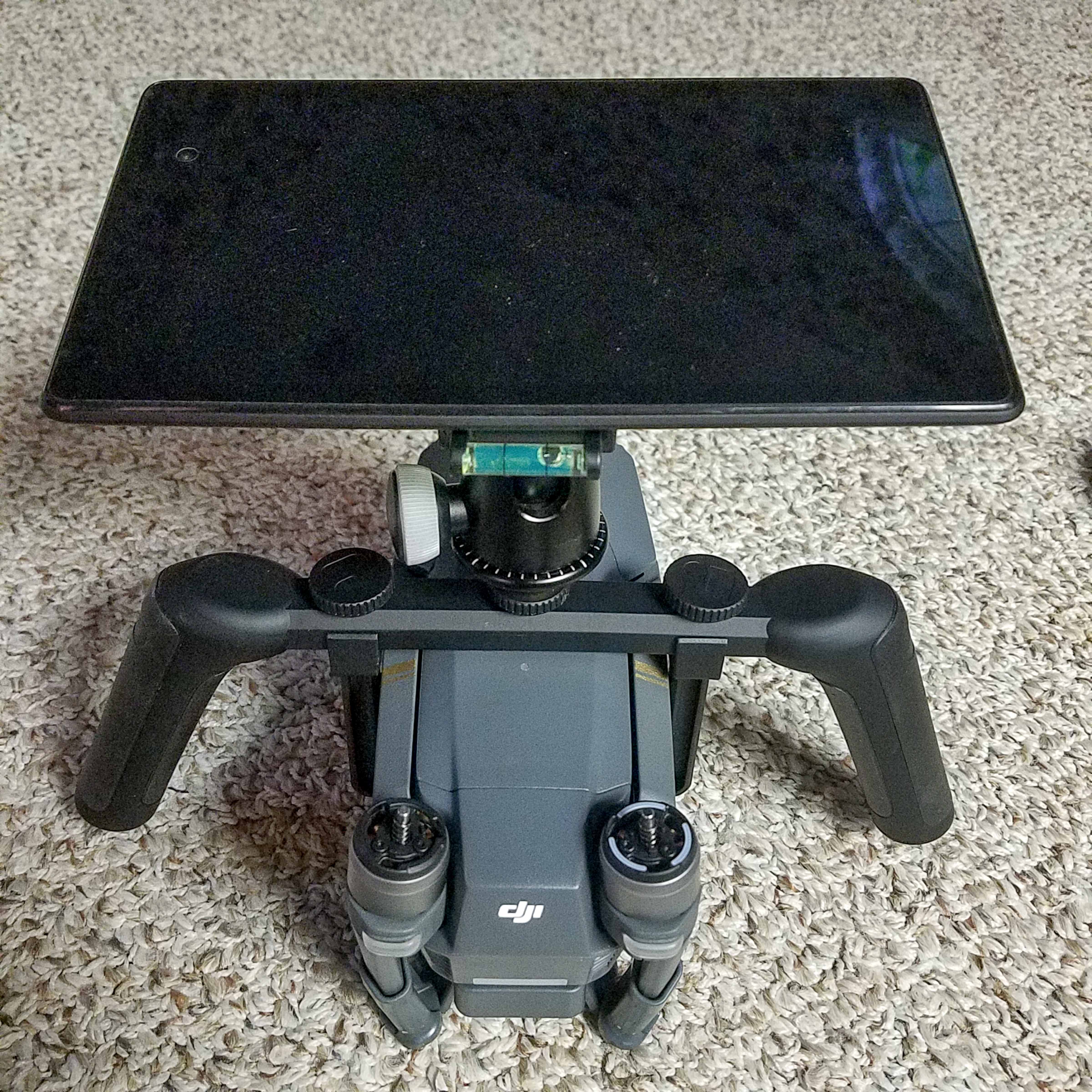

I recently acquired the Katana but found that my device (Nexus 7) was too big for the device holder (which should be made larger). So I broke in to my lighting gear bag and came up with a solution. Instead of using the stock holder, I added a small ball head. The ball head "sleeve" was adhered to the back of Nexus using industrial double sided tape to allow me to easily remove the sleeve from the ball head and not get in the way when docked on my controller. Here are some pictures if you are interested.
The ball head is about $25 at B&H and Amazon. You will also need a 3/8 female to 1/4 male threaded reducer screw adapter (about $3) and some strong double sided tape (home depot).
The cool thing is that the screen is now adjustable at about any angle. I can also flip Katana upside down with handle up (which I find more ergonomically comfortable) and the screen merely flips out as well for easy viewing.
