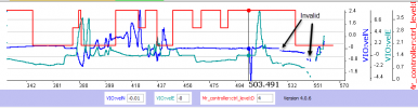

This incident occurred only when both navHealth dropped to 2 and the vision system data was not valid. This graph shows navHealth (ctrl_level) and the VIO velocity data. Invalid VIO data is indicated by the gaps.

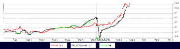

At time 558.5 secs navHealth was 2 and both VIO:velE and IMU_ATTI(1):velE were separating from the GPS:velE. I suspect the yaw adjustment was an attempt to make IMU_ATTI(1):velE track GPS:velE. Seems to have started to work before the impact.
