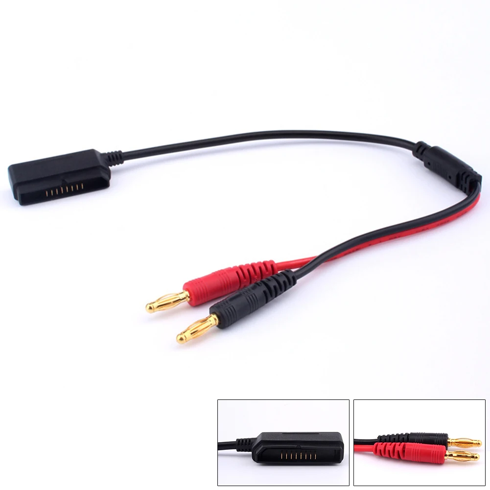

This looks what I need, amazing. I looked at the spec sheet but the charger attachment for the Mavic is not supplied, and it’s not a prescribed accessory, which is a swizz as it shows it on the website, charging a Mavic battery.
Do you know what connector the charger needs for the Mavic? I was going to look for one on Amazon.
Thanks
Thanks
I just searched 'Mavic Air charge cable' on AliExpress..amazon must have something too..but just remember this wont work if the chip is locked.
