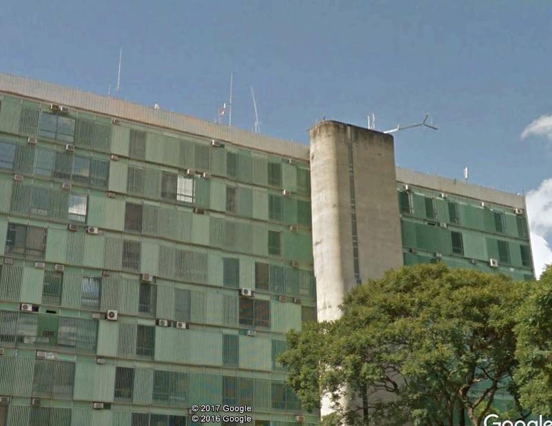

I came up with the same problem in the Home Altitude being 200 feet BELOW the disconnect point altitude and when you put that 10 story building in the way, you have a major problem.
HOWEVER, I think you MIGHT have survived that discrepancy if not for THIS very serious problem. Did you realize what was on the top of that building???? A VERY TALL and high power radio transmitter antenna. This alone could easily have overwhelmed the poor little DJI even if the frequencies they were using were nowhere near what the Mavic uses.
Here's a picture of the antenna
I think your flight was doomed right from the start.:eek:
Given the extra height of that big antenna, I think you may have crashed into the antenna.
You should get permission to check on the roof of that building. Your Mavic may hopefully be waiting for you up there.
Not only that but the mechanical rooms which are not correctly rendered in GE.

In addition to the large antenna that BerndM pointed out, there are also other tall masts on that building.
