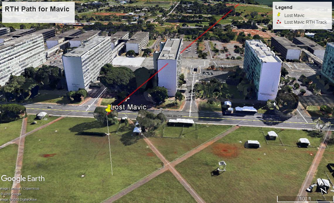

Here is a graphic that shows your Mavic and two different paths back to your location. The first picture shows the Line Of Site path between you and your Mavic. As you can see, it was blocked by the building. This is likely why you lost connectivity to your Mavic. I should also point out that you were facing a highway that was on a berm roughly 20 feet above your location- this was also blocking LOS to your Mavic to some degree.

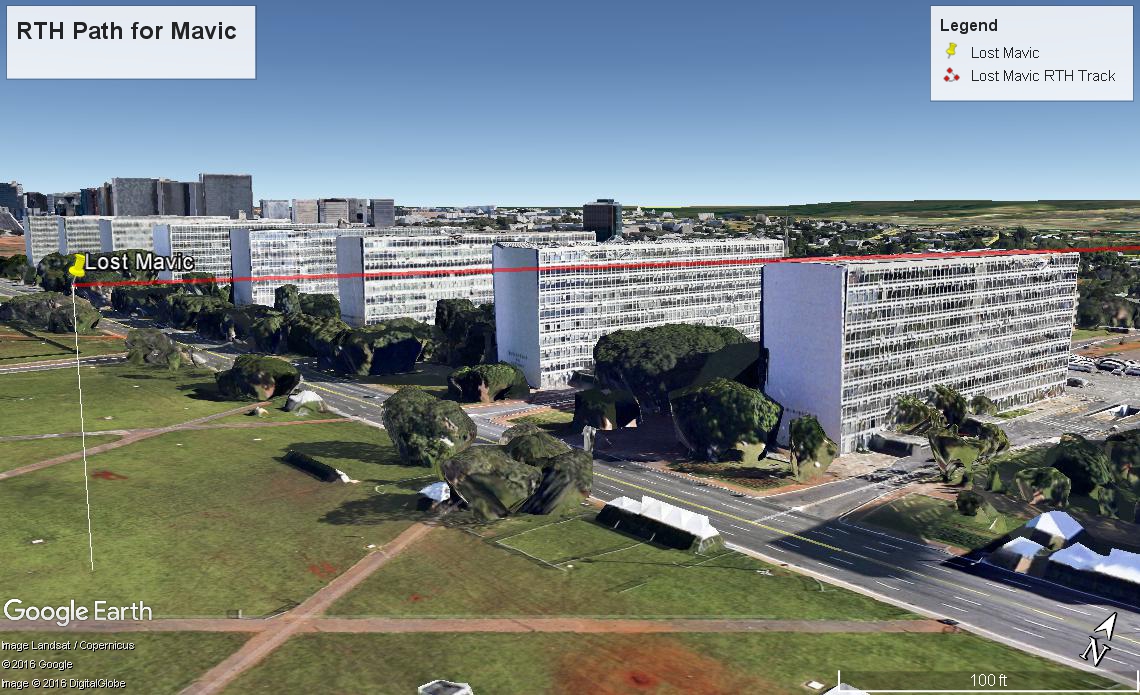

In this second picture, the actual RTH path at 103 meters is shown. As you can see, it would have barely skimmed over the top of the building, if Google Earth is accurate. It may have hit antennas or other objects on top of the building, or it may have simply hit the side of the building. It may even be on top of the building, ready to retrieve.
The most likely thing that he would hit is the mechanical room.
Fernando should pay the building manager a visit.

Actually I said, 90%: mech room; 9% side of the building! Glad you got it back.
