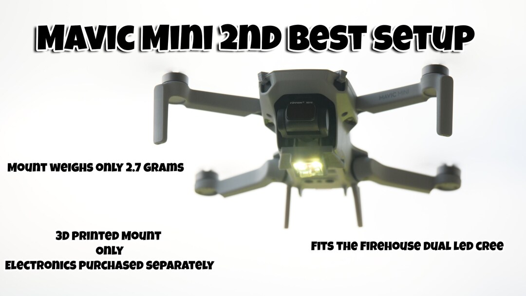

I went ahead and ordered just the strobe - no mount. Once I get it I will take a look but my thought is to use a design similar to the Firehouse unit but extend the arms attaching it to the drone. I would allow a 1/8" to 3/16" gap between the body and the upper surface of the mount. In my mind that would create a tunnel for air to pass through and vent. Part of the side vents would be blocked but none of the bottom.
Yes, a little more drag but hopefully manageable. Also, with longer mounting arms I should be able to vary the size to allow enough spring to allow it to hold securely but still be easily removable.
I have a 3D printer so it shouldn't be a big deal. I need to check Thingiverse as there already may be something there.

Just printed my version of a mount for the Firehouse Arc Strobe. I wanted the power button accessible, clearance for venting and easily removed. This is what I came up with and believe it should work fine BUT raining again today so no flight test. The four vertical tabs serve as landing legs but also by squeezing them together allow the mounting arms to spread making removal easy.
Looks good! I like the dual purpose of the legs and that that the mount is raised from the vents.
Question: Not seeing in your photos how thick the FAC actual board is, would it be beneficial to have air holes or slots in the mount for extra cooling for the mini and the board?
There is not a lot of space inside the mount box. Foam, battery and to the top of the board (not protruding components) is about 10.5 mm. I did leave the back totally open for cooling (plus it made printing easier). I thought about placing two small holes near the corners in the forward face of the box. That would allow a little air to move through but decided not to. As is the front area is fairly protected. But if it seems to run hot I will reprint with the holes.
