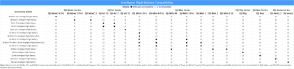

DJI says you cannot safely use Mini 3 Pro or Mini 4 Pro batteries in the Mini 5 Pro. Voltages are slightly different and even though it will launch, it will throw low power errors during flight that can lead to forced landings. Not good.
This is the only chart I can find so far, if someone wants to translate. The caption is below but unconfirmed.
"Note that mini 5 pro batteries are not reverse compatible with mini3/4. DJI also notes that mini3/4 batteries are smaller than mini 5’s, thus you should expect shorter flight time if you do so."
This is probably what you are referring to so while marked "compatible" the compatibility-testing has not been completed.

Several people online that tried eventually received intermittent insufficient power related messages during extended flight flights with accompanying forced landing notifications. Not worth the risk, as DJI Support now also strongly discourages doing so. Mini 5 Pro batteries only in the Mini 5 Pro.

At least one case of damage due to forced landing while using Mini 3 Pro Plus batteries in a Mini 5 Pro. Luckily, DJI have picked up the tab and the user has had a replacement drone. Lower voltage and higher power output from the 5 Pro batteries mean that 3/4 batteries aren’t going to work reliably even though they fit as the cause according to DJI was ‘a loss of connection’ but the motors just stopped and the logs showed loss of power.
