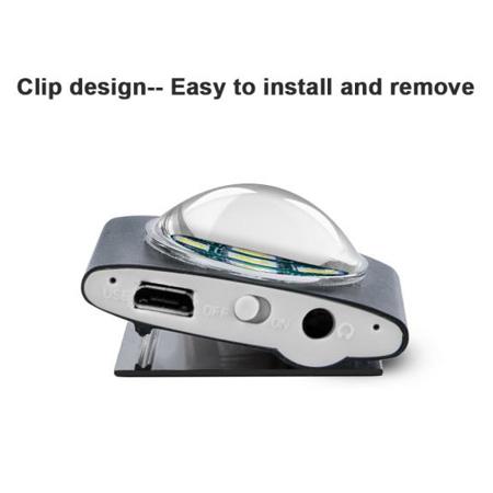

Wow, cheap as chips !
I watched the video to try and find out about the battery, nothing mentioned.
200+ hours, is it rechargeable ?
Or a button type battery ?
They are a little large compared to most drone strobes, eg a FHT Dual is the size of a small postage stamp.
But they could be some peoples answer to an economical option, maybe on larger drones though.
If people just want improved VLOS on the Mavic Mini, maybe just go for one white (the brightest of the leds), and place on rear if possible.
You can yaw around once slowly if you need to find it in the sky.
