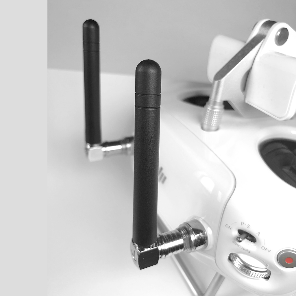

I fly over open ocean with my Mini 3 Pro in FCC mode, and am trying to get a bit more range. And sometimes I fly from inside my car and would love to get the antenna outside the car when going long distances. I've been seeing pics of N1 controllers with antenna mods, and just found one on eBay. Any idea if this is likely to get significantly better range?
Any other mods or built out controllers to try?

Modifying the controller to add two antenna connectors to be able to connect any antenna would give you the possibility of relocating the antenna to a better location, but you'll get the best range just by pointing the default antenna to the drone and keeping an unobstructed line of sight between the drone and the controller.

I'm hoping if nothing else the freedom to get better antenna placement will be a big improvement. I get less reception when facing away from the drone, or if the drone is at my hips, or I'm in my car.
If external antennas help with that, fantastic. And if I can mount those antennas up on a pole, even better. I have to figure out which cabling to use though, and it probably won't be cheap.
