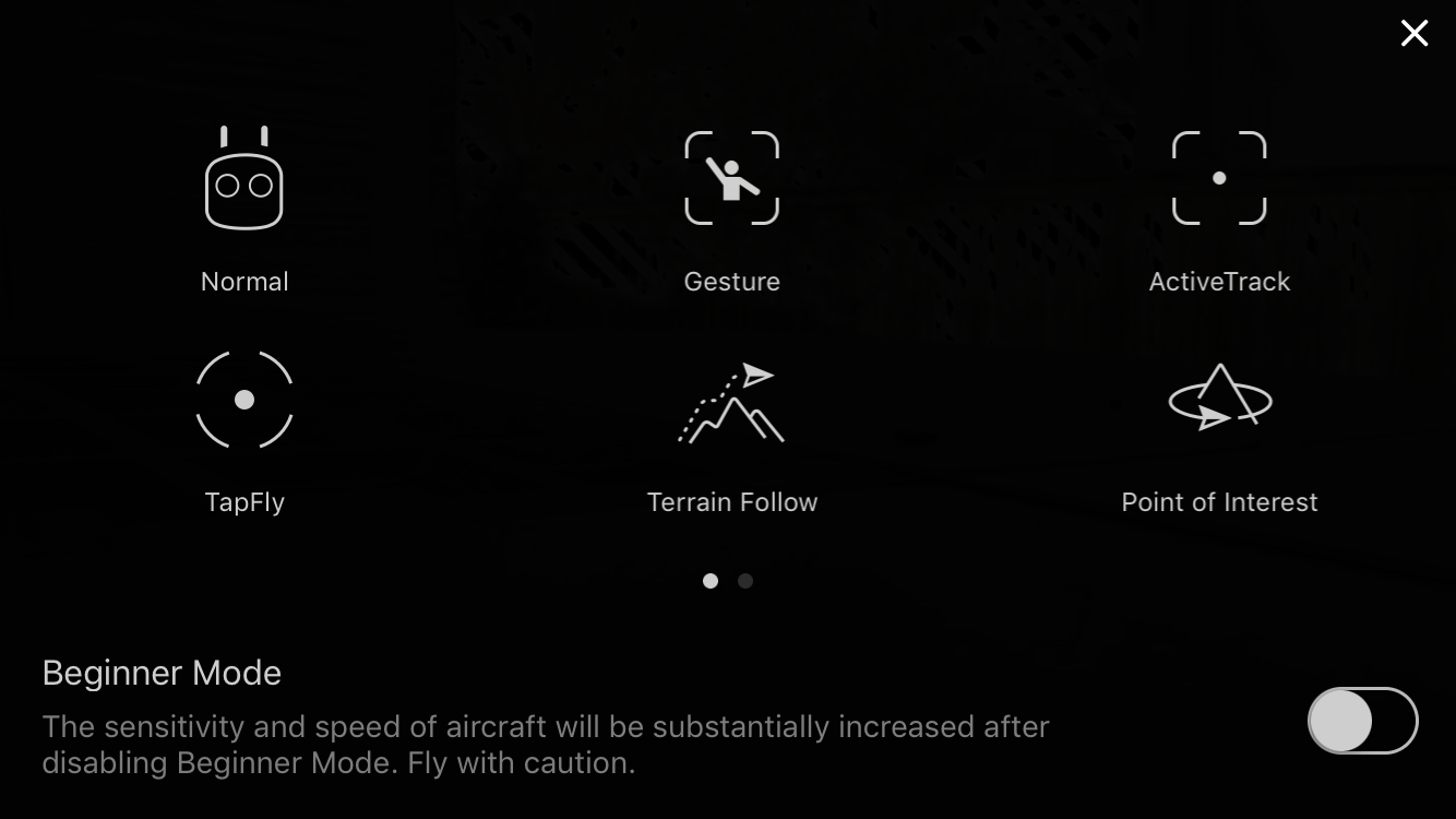

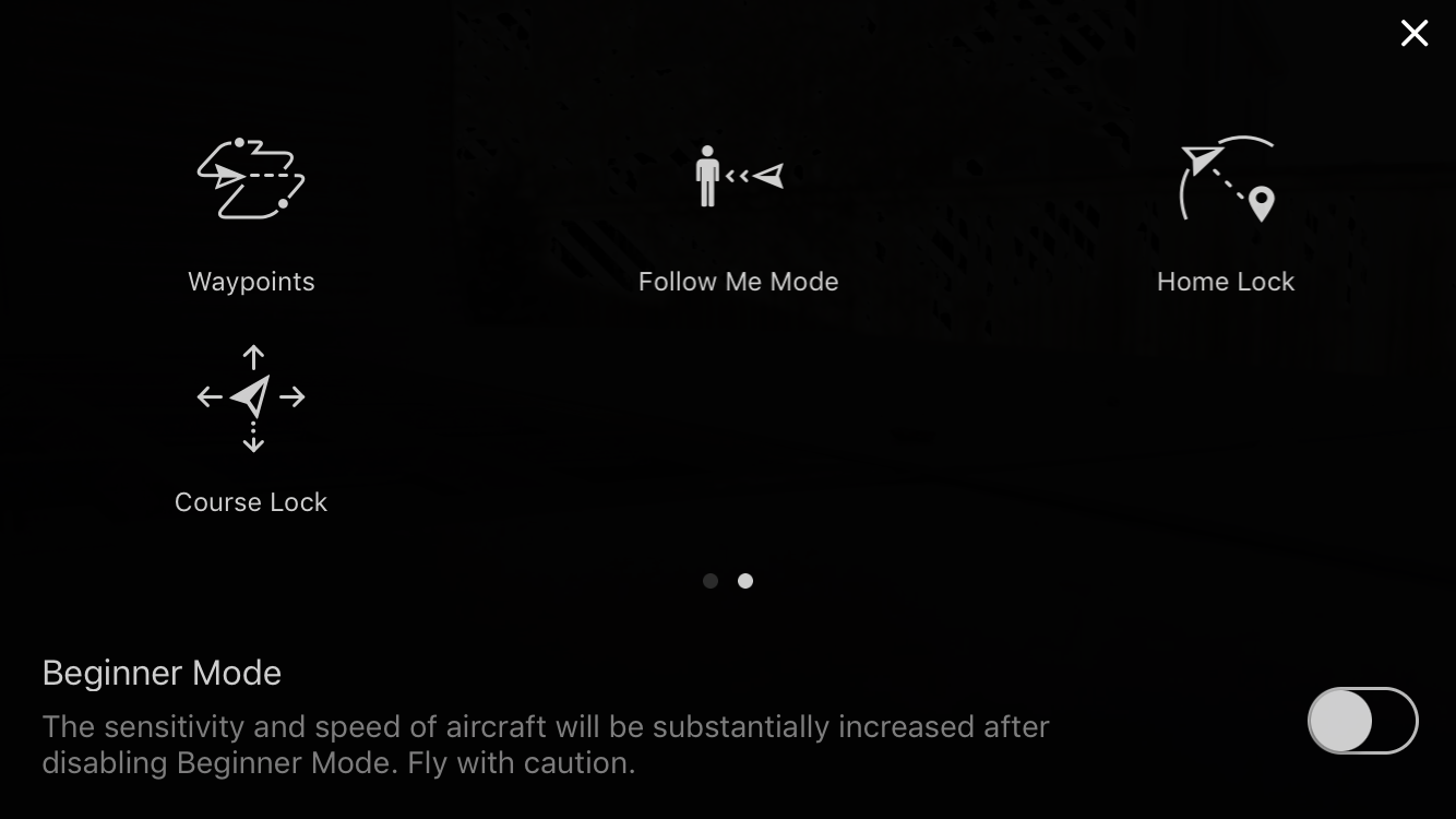

Tripod mode missing? UPDATED with possible fix.
Can you try to post those again? I cannot access them.

Yes, they are displaying now.

I have updated my firmware to the latest... i have checked and rechecked my settings. im not on sports mode, i tried combination of turning on or off the OA sensors. I swipe left and right up and down. Basically, i did what i would tell people with the same problem.... And the tripod mode still doesnt show up.
