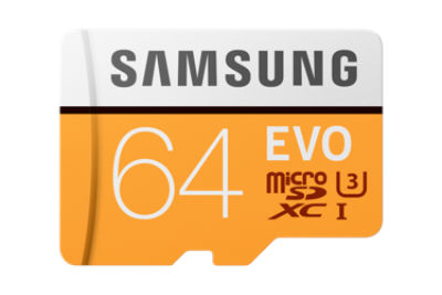

I do use a Samsung EVO 64GB card. Around $30 here in Norway, Works fine.
Up to 100MB/s Transfer speed with Class 10 and U3 compatibility. Includes Full-Size SD Adapter.
MB-MP64GA_1_041217
Excellent Performance for 4K UHD video and broad compatibility across multiple applications. 10-Year limited warranty.
Reactions: TheoKondak
