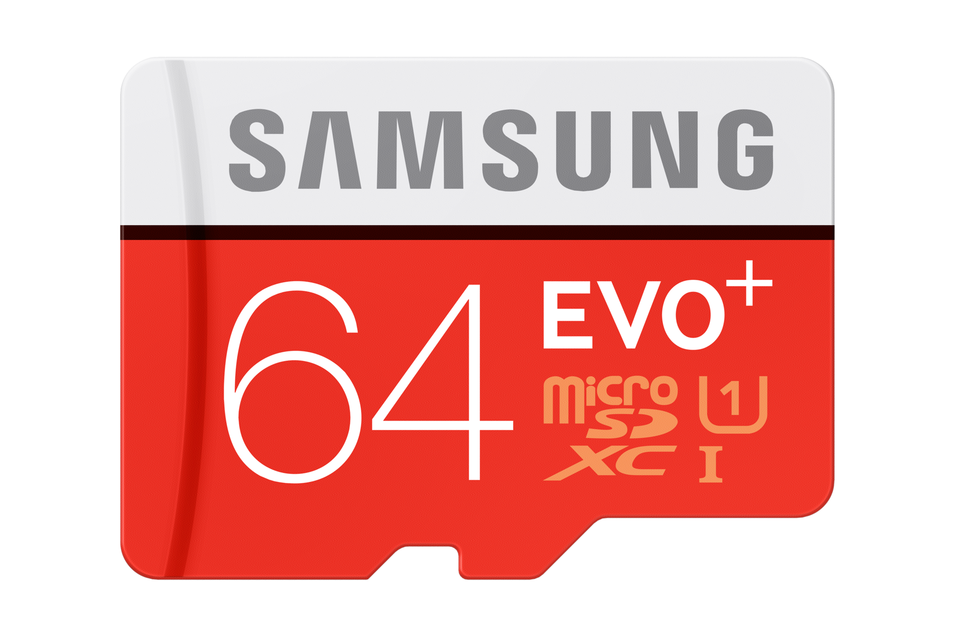

I've been using 2 of these that I swap between flights. They have more than enough write speed for 4k recording, have been reliable, and are reasonably priced. I bought the pair from amazon for less $20 each a few months ago.
uk_MB-MC64DA-EU_001_Front_red
Two Samsung PRO (64G) and two Lexar 633x (16gb and 32gb). I shoot in 2.7k so the PROs are probably overkill, but just in case :)

The Samsung card (red and white one) isn't one I've tried to use in the Mavic, but it's good to know since it's ~$10 less than the Sandisk last time I checked. I'll vouch for the Samsung's durability over time, though: I use that very card in my Raspberry Pi 3 at work ever since I got tired of carrying a laptop charger and decided to just put something together and power it with one of those little power packs you get in Walgreens.
