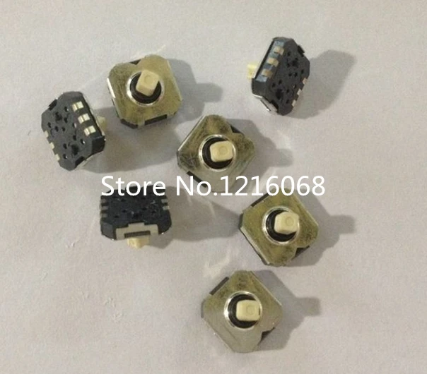

Is this the shaft you're referring to?
I believe that shaft is permanently connected to a board like this:
Reactions: TampaTC
Do you carry these parts or have somethign liek that on hand?
No, I don't carry/sell DJI parts. I tried searching for that part, but was only able to find boards for the Mavic Pro remote controller.
I appreciate the help. I wonder if I can find a closer picture of that board or someone that has theirs cracked open currently to grab one?

I talked with Digikey and they don’t happen to carry this exact switch. I was hoping when I disassembled mine I could find a part number for the whole piece.
