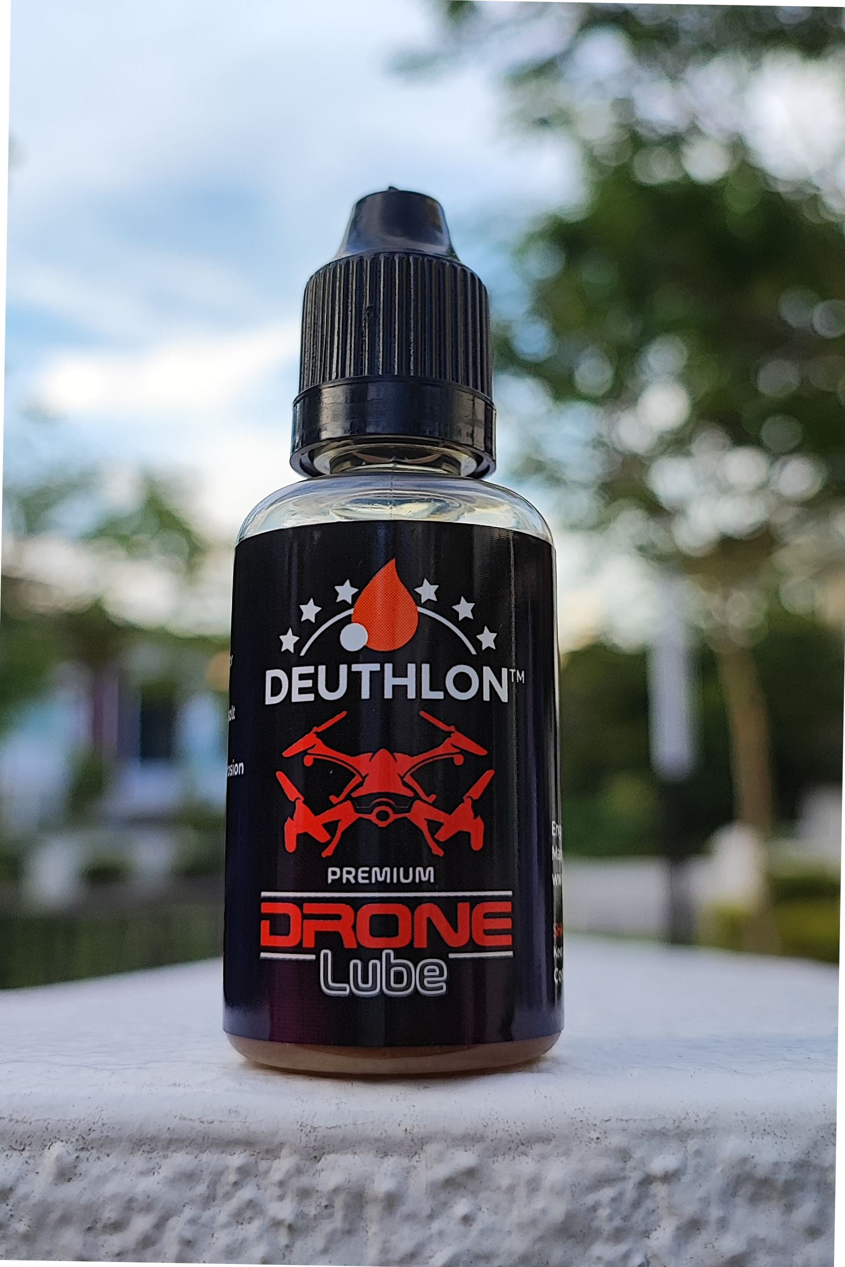

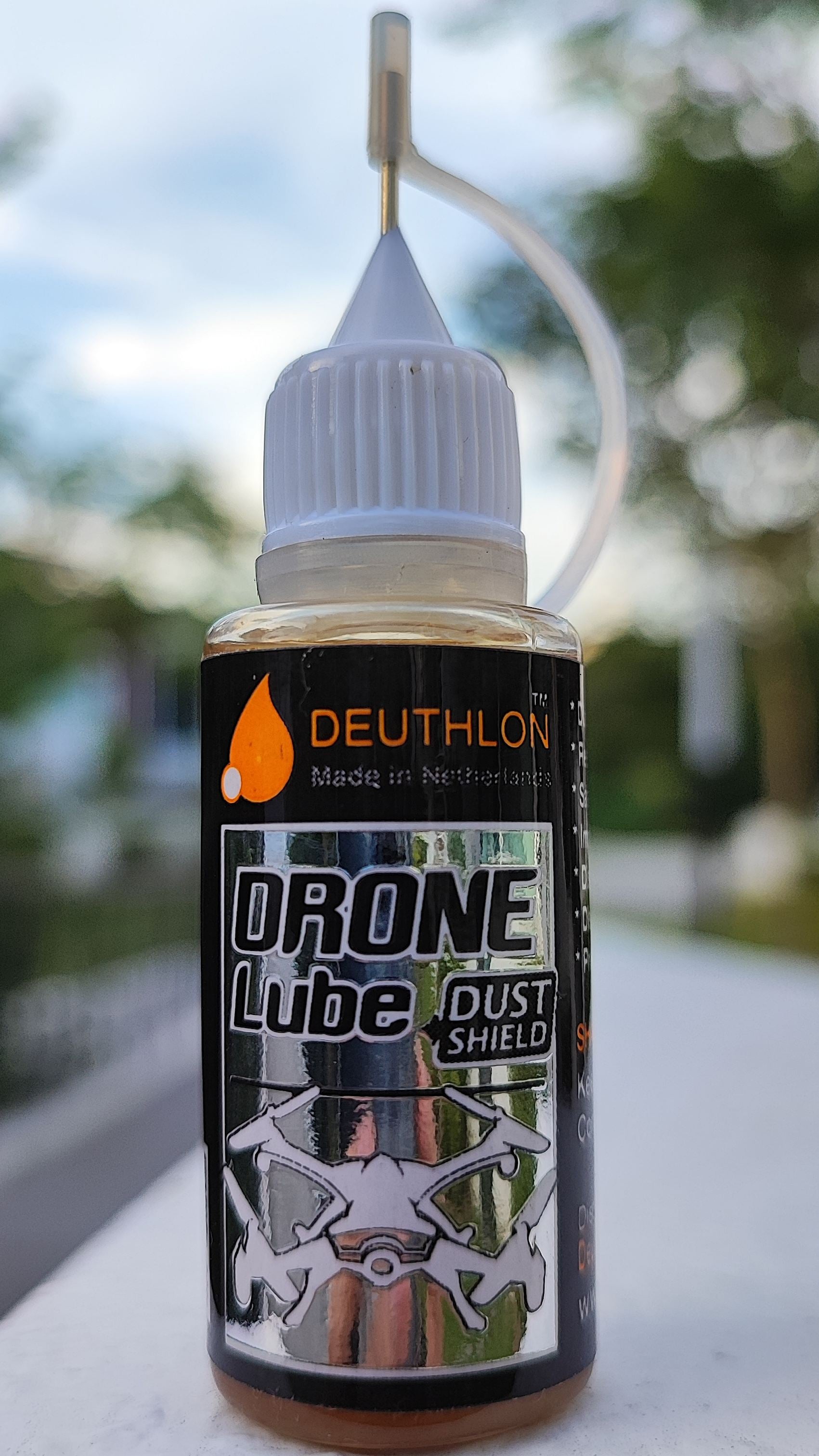

If you do clean anything out of the motor, dust, a few grains of anything, you could try a little drone motor lube in there.
I wasn't aware it existed until I saw it recently, very commonly used for racing drone motor lube, obviously at the cutting edge of performance.
I wouldn't bother for a normal DJI type drone, unless you wanted to give it a go on finding minor debris in that one.
