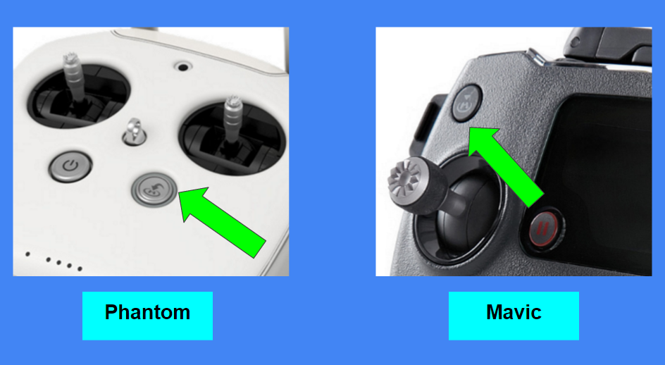

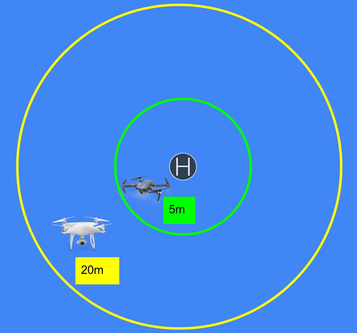

Well, each time you use the Return to the home button you might get a very different result to what you were expecting...
TKK3VTvLNYHxPo2uXS4qKBHnSdHAokfZv_pFGzPkg2Yc8sTnPUEESTJCuoDXCuSzw1UEToFC8AAEyyTwOQqildXi3FWwyOrc9eDRyVIlny1dc-qARPe9a5sXGaqbvB4OWT2o892b
For example, you can cause the drone to go into landing exactly where it is!
If your drone is within 20 meters of home point and you press RTH it will not fly back to the home point but it will land where it is…
Even over water!!
And this applies to the Phantom 3, 4 and 4 Pro
Luckily for the Mavic DJI got a bit smarter and limited this to 5 meters.
iZNMjkcjkwVO38_cMWOaQf9Kwiy_egW2kL1t8dIQEdNCdEXLVw3CLR1kemRy88H2oUxovOiDeFb3qUCZpme0a7I4uT1N5mQtaRbdx_3zq3G-DqAxDVbmtgODZ4cySpmbLDbbgIut
So watch out when invoking RTH - you might be within the 20/5 meter trigger and go into landing where you are and this could be a COSTLY mistake!

Nechci byt kverulantem ale to RTH chovani je komplet popsany v manualu...
