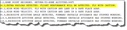

Hi. I lost my mavic2pro yesterday in Greece. I have attempted to attach the flight logs. The battery acted a little janky previously and I had another battery a few months ago short out and stop working while landing. Any thoughts on cause? Thanks.
I was about 3 mins into flight not far offshore and I got a message—Aircraft Disconnected. I waited to see if it would RTH but it did not.

Your flight data doesn't give away many secrets.
You launched with a full battery, flew up and out.
And at 135.3 seconds the data just stops, with the battery still good, no extreme movements, no indications of a collision.
It looks like a case of sudden loss of power.
Was the battery at all swollen?

Yeah ... this is very likely a dislodged battery causing a sudden power loss.
At 135,3sec you releases a full aileron stick which had driven up your M2P to 9,3m/s which required a positive roll of approx 34 degrees. Just 0,1 sec after the stick release (blue dotted graph) the log ends ... probably a fast negative counter roll to break broke the battery lose (sudden swelling weaken the attachments) & that cut the power.
Did you have anything attached to your craft ..?

I did not. That was perplexing to Me too.
Thanks for all of the replies. This helps and makes me feel vindicated although I need to pay attention to battery swelling. I did check my remaining battery and there is no swelling.
