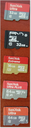

There’s a known issue with the Mavic Pro and certain SD card that can make the gimbal bug put like that. The Sandisk Extreme Plus 32GB is the worst offender by far but there are others. Which SD card are you using?
An SD card can cause the gimbal to wig out? Wow.
I'm using a Sandisk Ultra PLUS 64Gb V10 XC1 C10 A1

Yea so that card is no good for the Mavic Pro. You need a card that says U3 or V30 on it which refers to the minimum write speed of 30mbps. The card you are using is a minimum 10mbps it’s not fast enough.
Why this causes the gimbal to freak out I don’t know but it’s well documented. My theory is that the cache on the camera fills up and so the camera has no choice but to restart itself to clear the cache and what you are seeing is a partial reboot and recalibration of the camera/gimbal. Purely speculation though.
As I noted earlier there is a 32 GB Sandisk Extreme Plus that is known to cause the same issue even though it’s labeled U3/V30. I don’t know if they just had a bad run of them back in the day of why that specific card doesn’t work when it should but steer clear of it. Other sizes of Sandisk Extreme Plus work fine.
I use to have the same problem and have been tracking it for some time. 9/10 people who have this issue were using an insufficient card and it was fixed with a card that meets the minimum required specs and wasn’t the Sandisk Extreme Plus 32 GB
What the...! Well, I do have some other U3 cards, so I'll give those a try.

Seems I only have a 16GB u3 card. Well, it'll be enough for testing anyway.

That SanDisk Extreme is a good one.
It was my experience too that it didn’t happen every flight. I noticed you were recording when it happened did it record the incident to the SD card? If it did record this may not be it but you should be using a U3/V30 card anyway.
The first glitch shut off the video; the 2nd glitch didn't! Well, either way I'll test with the U3, and it looks like now I have a 64Gb card for my old gopro 4 silver...or a 2nd one for my old reliable Autel XSP! :)
