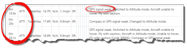

Thanks for the help. Just done that and it shows so very weird things going on.
0m 19.8sP-GPS7satellites16.1ftN/A1.1mph0ftGPS signal weak. Hovering unstable. Fly with caution (Code 30002).
0m 19.9sATTI7satellites16.7ftN/A1.1mph0ftGPS signal weak. Switched to Attitude mode. Aircraft unable to hover. Fly with caution.
0m 20sATTI7satellites17.4ftN/A0.9mph0ftCompass or GPS signal weak. Changed to Attitude mode.
0m 20.1sATTI7satellites18.0ftN/A0.9mph0ftGPS signal weak. Switched to Attitude mode. Aircraft unable to hover. Fly with caution.; Aircraft in Attitude mode. Unable to hover. Fly with caution (Code 30004).; Compass or GPS signal weak. Changed to Attitude mode.
0m 20.3sATTI9satellites19.4ftN/A0.7mph0ft
0m 20.7sP-GPS9satellites20.3ftN/A3.4mph0ftGPS signal weak. Hovering unstable. Fly with caution (Code 30002).
This is what i experienced and then tried to return.

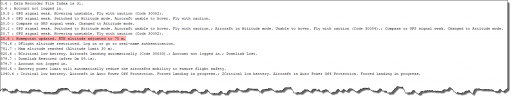

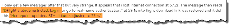

I only get a few messages after that but very strange. It appears that i lost internet connection at 57.2s. The message then reads "DFlight altitude restricted. Log in or go to real-name authentication." at 59.1s into flight download link was restored and it did this "Homepoint updated. RTH altitude adjusted to 75m."

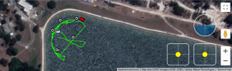

From the point i could not return back to the shore. The picture below shows the flight path trying to get back. it seems to have locked me to a radius circle 40m out into the reservoir only letting me move 30m in any direction.

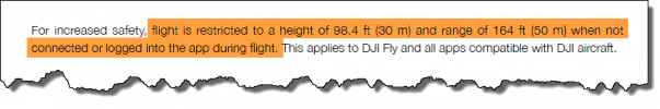

But suspect that this is due to what is written on page 2 in the full downloadable manual --> https://dl.djicdn.com/downloads/Mavic_Air_2/Mavic_Air_2_User_Manual_v1.6_enIII.pdf
If first looking at the pic you showed over the flight from PhantomHelp ... all flight paths is out over the water, no path goes to a possible HP over solid ground.
This means that you most probably flew out over the water without a GPS lock & by that no recorded HP. This is somewhat confirmed by another pic you shared from PhantomHelp ... ATTI mode very early in the flight.
So by flying out without a GPS lock prevented the distance & height restrictions I showed you from page 2 in the manual above as it wasn't any HP to relate the distance too.
Then out over the reservoir you got a GPS lock ... & a HP was recorded then & there. This made the distance & height restrictions active as it now existed a HP to relate too... and the green flight path start to appear in PhantomHelp.
This + that you wasn't logged in to your DJI account in the app is somewhat confirmed with what you write here ...
So it appears that this was a plain pilot error coming from not waiting for a GPS lock & a recorded HP before take off + not being logged in to the DJI account in the app.

All above & more is also shown in the TXT log message stream... the HP became recorded for the first time at 25,6sec into the flight. It also already at 0,6sec confirms that you weren't logged into your DJI account in the app.
(Click on the pic to make it larger)
When the HP got recorded your MA2 was out over the water, approx 22ft above the surface ... the red star is your AC location when the HP gets recorded (the green bar shows in which direction it points), the green star is where the HP got recorded.
