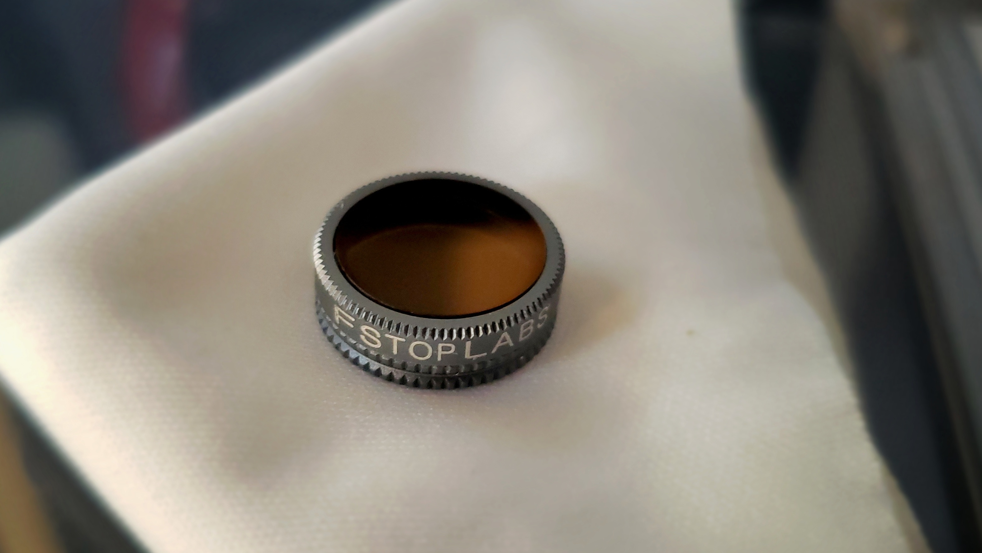

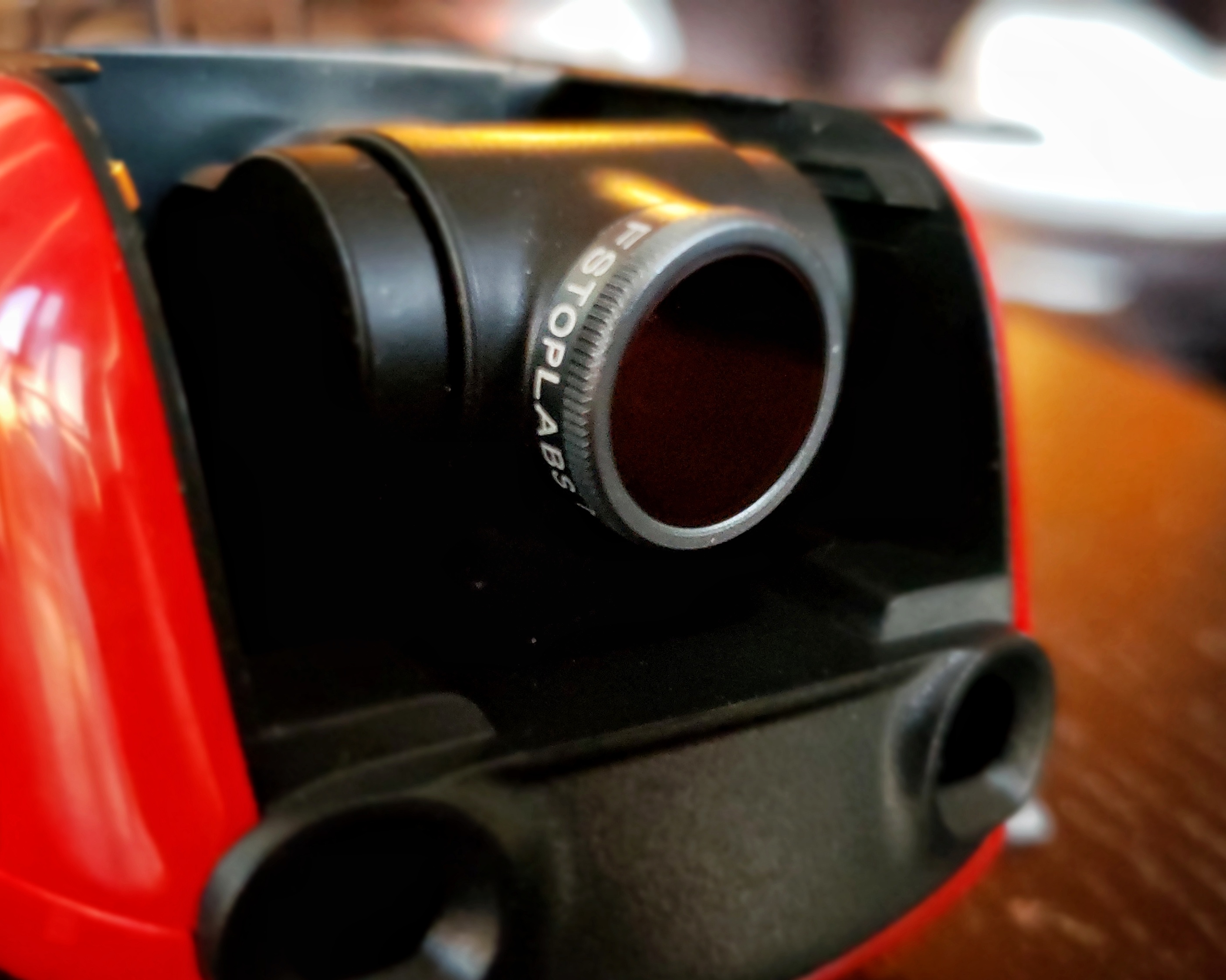

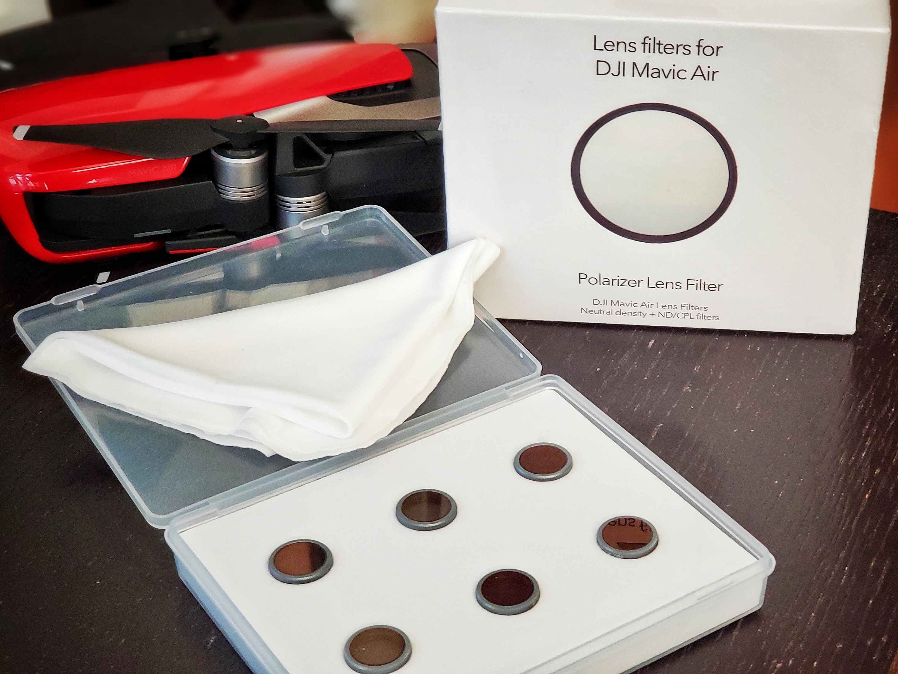

I have the Polar pro for my Mavic pro and they are great filters but I have the FSTOP Labs bundle ND filters for the Air, ND and 4, 8 ,16 includes polarizer as well so total of 6 filters..they are just as good as the Polar Pro but less expensive. I’m about to buy the ND32 as I fly a lot around noon when sun is really bright...I recommend them.
