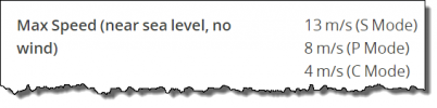

...what is the headwind capacity of the mavic mini.
Below is straight out from the specs for a Mini ... it's the maximum air speeds in the different modes. (RTH operates with P-mode speeds).
If your Mini is fighting an equal high head wind speed it will not achieve any ground speed at all ... if the head wind is even higher, the Mini will be blown backwards.

That raised the question to me what is the headwind capacity of the mavic mini.
Every 1mph of headwind the drone has to fight, takes 1 mph off the drone's speed over the ground.
Since the Mini isn't a fast drone, it doesn't take much wind to cause a significant problem.
It's important that you plant your flight so that don't put the drone in a situation where it will have a long flight home against a strong wind.
