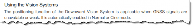

All DJI drones heavily relies on a GPS to hold position when you release the sticks or being affected by outside forces like wind... most of them have a secondary system called Visual Positional System also, that up to a very limited height can lock on to the surface beneath the drone, but for that to work the surface needs to have a clear pattern with a proper structure & good lightening.
A slight correction... VPS is the primary positioning system below 30-45ft, depending on the model and sensor system (ultrasonic vs. IR). GPS is ignored entirely when in VPS range.
This is why a DJI drone will "hold" position over an object in a stream and follow it with the water flow, despite the fact the GPS position is changing.

Any reference to that?
Have never ever seen a incident with a drone following a object in a stream without a sketchy & weak GPS reception (meaning a low GPS Level recorded in the log).
This is for instance from the Mini 3 Pro user manual...
There was a recent discussion of this in another thread, logs were examined confirming that VPS is providing primary positioning sensing when in range. Some thread about yaw error and flyaways IIRC.
It make sense, of course. GPS lacks the accuracy necessary to hold position as precisely as our drones do. There would be quite a bit more perturbation around the "hold point" than there is.
So no link... would be interesting to follow the reasoning behind that conclusion?
And just because the GPS lacks the hover accuracy expected when flying low doesn't mean that good reliable GPS positional data is ignored... if that had been a fact, it's really strange that I haven't seen it in all numerous incidents over the years. If a drone hovers low over a stream with floating objects & have a reliable GPS lock, the VPS can try to follow objects, making the drone drift slightly back & forth... but that doesn't mean that the GPS is ignored.
