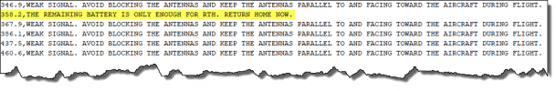

Yep ... you flew your battery until it was drained & couldn't manage a return flight.
In the log no RTH phase is visible ... you got a warning about low battery RTH but you cancelled that at 558sec into the flight & continued. The flight was really sketchy connection wise ... you should have aborted this flight long before this.
(Click on all pictures below to make them larger)
Here below is a chart with all interesting data regarding the flight ... the markers is placed just in the end & you can read off the last values from the chosen graphs under the chart ... will not go into what everything shows, instead just come to the conclusion directly further below.
There in the end you had 17% (on the way to drop to 16%) battery left ... & depending on the height your AC was at the low battery force land was defined to 14% battery. Your failsafe setting was GoHome & the RTH height 100m (but as you were at 113m the AC would have remained at that height) so in case of a signal loss longer than 2sec the craft would have started the failsafe RTH by first start to backtrack the flight route for a maximum of 60sec.
But as you only had about 2% battery left to low battery landing ... and with an interpolated consumption of 13,1sec flight/battery % ... you only had 26,2sec flight time left. Take away 2sec waiting time before the backtrack started & you had approx 24,2sec flight time left for the actual backtrack ... & with 14m/s that would mean 336m until landing.
So moving back & follow the earlier route 336m your AC likely ended up here when the low battery landing kicked in. Have noted the GPS coordinates in the picture.

When your RC have been disconnected from your AC you can push the RTH button as much as you want ... nothing will reach to the AC though, that's why no RTH was initiated.
There in the end just before the final disconnect you were actively flying the AC with a mix of full elevator (for forward)+ full right aileron (for flight to the right) ... & you also were putting in a sporadic yaw rotation. Didn't look like you were in a hurry to get back home?
Right there & then you had 26,2sec of flight left until the forced low battery auto land would have kicked in ... & you were 410m away in a straight line from the HP ... with a 14m/s speed you had managed to get 366m until landing.
To me that seems to be pushing it a bit to far ...
Try to visit the position I've market in the sat picture ... maybe you can find it near there.
