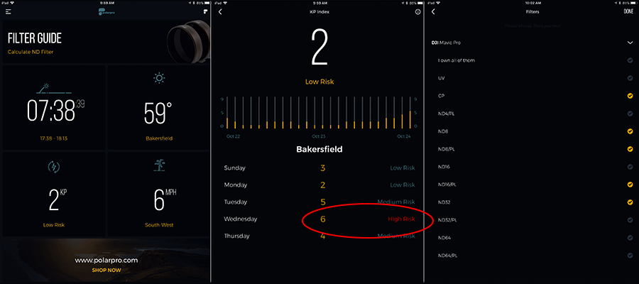

This app looks great but I have an issue with it. Basically, even if I tell it that I own the whole set of PL filters (ie they're all checked in the relevant panel), I won't be able to see and select them in the "Filters Installed" field.
Telling the app that I own the regular, non-PL filters results in it displaying those properly.
Checking the "I own all of them" results in the app displaying once again all the non-PL filters.

Hi Tiax,
Thank you for bringing that to our attention. I have informed our development team of what you encountered. They are constantly updating the app to ensure the information in it is accurate, so the absence of the polarizer filters may be a part of some maintenance they are performing. Another update to the app is in the works, so please keep an eye out, and if you have any other feedback don't hesitate to let us know.
- Oliver from PolarPro
It's so cool of PolarPro to serve up a handy, free app and watching how the firm has listened to user feedback over the course of this thread. Turns out there's a high-risk Kp event three days from this post warning of significant disturbances in Earth's magnetic field impacting quadcopters. Good to know. Available for Android and iOS at Apple's App Store and Google Play. Thanks, PolarPro.
