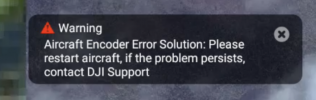

I have a Mavic Pro Platinum and have been using Litchi for over 6 months with no issues. Litchi just updated to a new version for Android and now, every time I boot up I get this warning message about Aircraft encoder error. I've restarted many times to no avail. I don't get any similar message using DJI Go 4. I'm sure it has something to do with the new version of Litchi. And, of course, there doesn't seem to be any way to contact Litchi to ask about it. I've run literally hundreds of missions using Litchi and have never seen any messages like this. I've refreshed my DJI firmware in the AC and still always get the message. I know there have been threads on this topic before, back in 2017, but all indications there say the issue was resolved. Anyone have any ideas on if this message means anything or how to get some input from the fine folks at Litchi?

I have been in contact with the Litchi people and they did confirm that the latest release of Litchi in November 2020 now displays new messages previously not seen, like high wind warnings, aircraft is tilted and other various messages. They do not understand the aircraft encoding error message and suggested I can ignore it. I have flown at least 10+ missions with Litchi since getting this new message and I get it multiple times on every flight but it never seems to cause any issues. I do know that I did not get this message under DJI Go 4, at least I didn't the couple times I tried, I usually use Litchi on waypoint missions.

Here is an image of the Encoder error message;
I too am experiencing the same issue, very similar if identical experience to Chuck715's experience, and like the rest of us would like know whether anyone has manged to resolve the issue.
I see it as well, does not seem to impact the performance as far as I can make out.
Thanks for the response, but as we all know any impact might have disastrous results. But it is reassuring to know I am not alone with experiencing this problem.

Same problem for me today. Everything is perfectly updated. Using Android
I've been getting this same message ever since I updated to the latest version of Litchi, it doesn't matter what device I run it from, i.e. Samsung S9, Huawei T5 Tablet, or the DJI Smart Controller it always pops up, even during a flight a few times, it has NEVER had any effect on the outcome of the flight or misiion (waypoints) so I just ignore it, I find it more of a nuisance almost like a pop up ad or something now & never worry about the flight going wrong, I have flown dozens of flights & all has been fine, I think it is a software glitch in the Litchi program & it just needs an update to fix this only. ( I run a Mavic 2 Pro, latest firmware, for reference )
