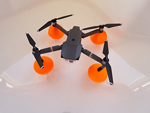

For your next Mavic... 35/38 USD

The alternative is neither lost the drone or try acrobatics maneuvers... Is to set floats... 35 usd
