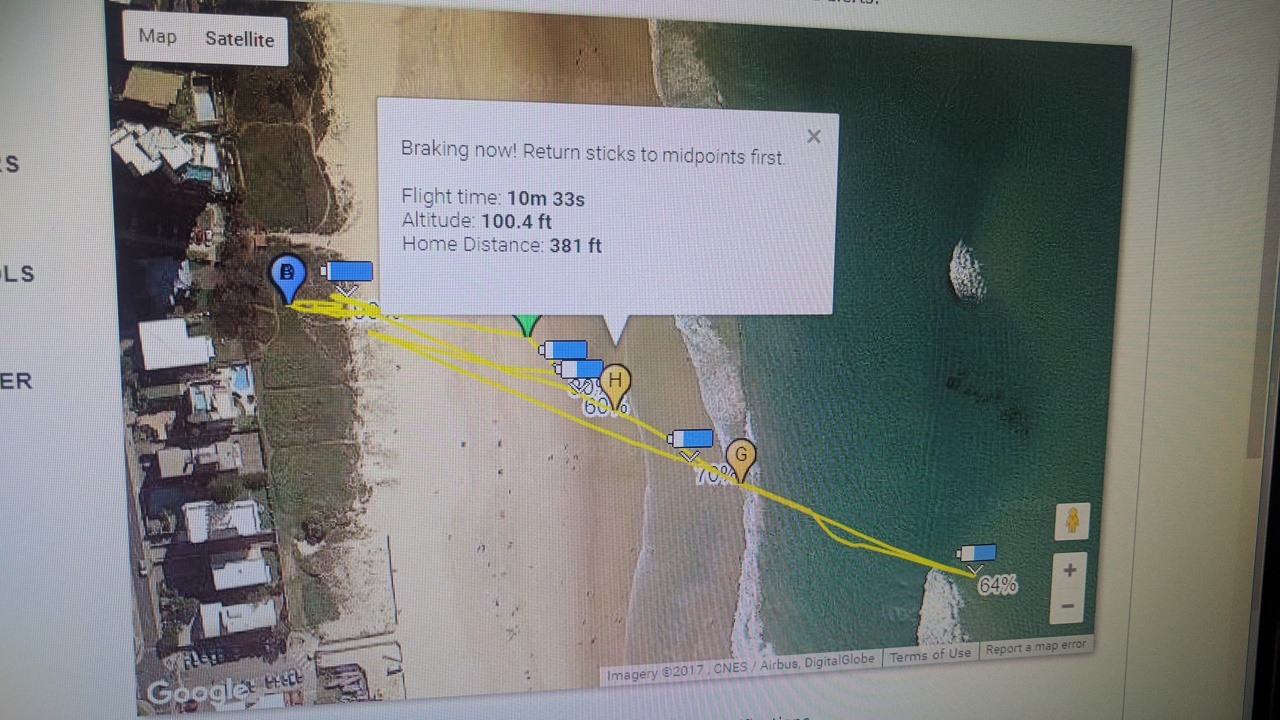

Flying at my local beach today and started getting a couple of warnings that didn't make any sense to me. I think are collision detection warnings? There was nothing in the sky, and I've had crows fly in front of the drone a few days ago that I could see on the screen and they were not detected...
Usually it's when you are pointing towards the sun - like the camera the front sensors seem affected by refraction.
Unless you are likely to be near things to hit it's best turned off - but you can leave the radar on, and it will beep when near to things.
OA reduces your top speed by quite a lot and it is less able to fight strong wind too
Sometimes heading towards the sun can initiate the OA causing the issue you see.
Its quite common and not a whole lot you can do to remedy it.
Hmmm i am thinking I can just turn of the collision detection sensors? I flew a phantom 2 for two years with no crashes and no sensors!
