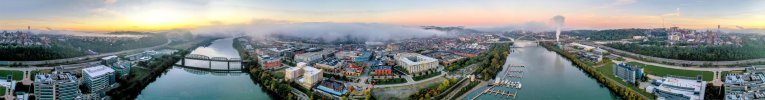

I haven't done a 360 with the Mavic, but I have with both my P4P and I2. I do it manually, shooting each image with AEB5, and try to overlap each image by at least 40%.
I then process the HDR with Photomatix, and then use PhotoShop to File-Automate-Photomerge. I use auto layout option, and then select blend images, vignette removal, content aware fill. (Not Geo Distortion!). The file is then huge, but I have a pretty good machine. I work then to adjust any flaws.
Here's are 2 360's. Pittsburgh is 401 full res (tif) and Church Pan is 1 GB. (That's from the I2)
Hope that gives you an idea of how to do it. I'm sure I could do it easier, it's just what I have developed.

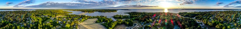

Try the free Microsoft Image Composite Editor. Google to find the download. I've used it for all my panoramas. Besides stitching, it gives you many different projection alternatives, cropping and export to a file. It does a fantastic job to stitching without artifacts, and it's fast too. Here is one example, a "tiny planet" projection. There were 25 or so 20mpixel images in the original. I output to a jpeg, that's why the file size is pretty small. Good luck!
