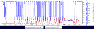

...because I was actually flying directly towards the sun.
...Here is the .dat file.
The DAT log doesn't show anything else than the TXT log. This incident is pretty much what we have seen in the past earlier, especially from Mavic 1 & 2's. But now lately it's surfaced again but now involving Mavic Air 2's.
The OD sensors misjudge the bright light for an obstacle & treat it like that by following the coded process regarding obstacle avoidance during RTH.
Below is the complete RTH phase in the flight ...
The darker green background is the RTH phase
Red is height
Green is heading speed
Blue is vertical speed (positive value=descent)
Magenta is AC pitch
Grey is yaw angle
Pretty clear that as soon the AC have yawed towards HP & starts to get heading speed it pitch up (positive) for braking, there the vertical speed goes from nearly 0m/s to negative value for ascent ... then it repeats, with a slight increase in height for every loop.
Here the same but zoomed in so it's easier to follow the change in heading & vertical speed relative pitch & height increase.

No ... nothing of that is correct, you need to read the log instead of just guessing ...
Red is height
Magenta is AC pitch
Grey is yaw angle
Just to add a bit more to this. Looking at the .DAT it can be seen that the MA2 thinks there is something in front to be avoided.
Interestingly, there is also an avoid_front_m and avoid_front_r which don't show much. I'm assuming that avoid_front_l, avoid_front_m and avoid_front_r are left, middle and right, respectively. So, the sun was in front slightly to the left.
Very good - the sun was in fact 30° to the left of the aircraft heading. At that location, at 1505 on February 13, the solar azimuth was 222° at an elevation of 22°. The aircraft heading was 252°.
Yep ... trawled through all columns in the DAT searching for all with "avoid" & "brake" & saw them ... but being unsure what they actually indicated I left them unmentioned Thumbswayup
