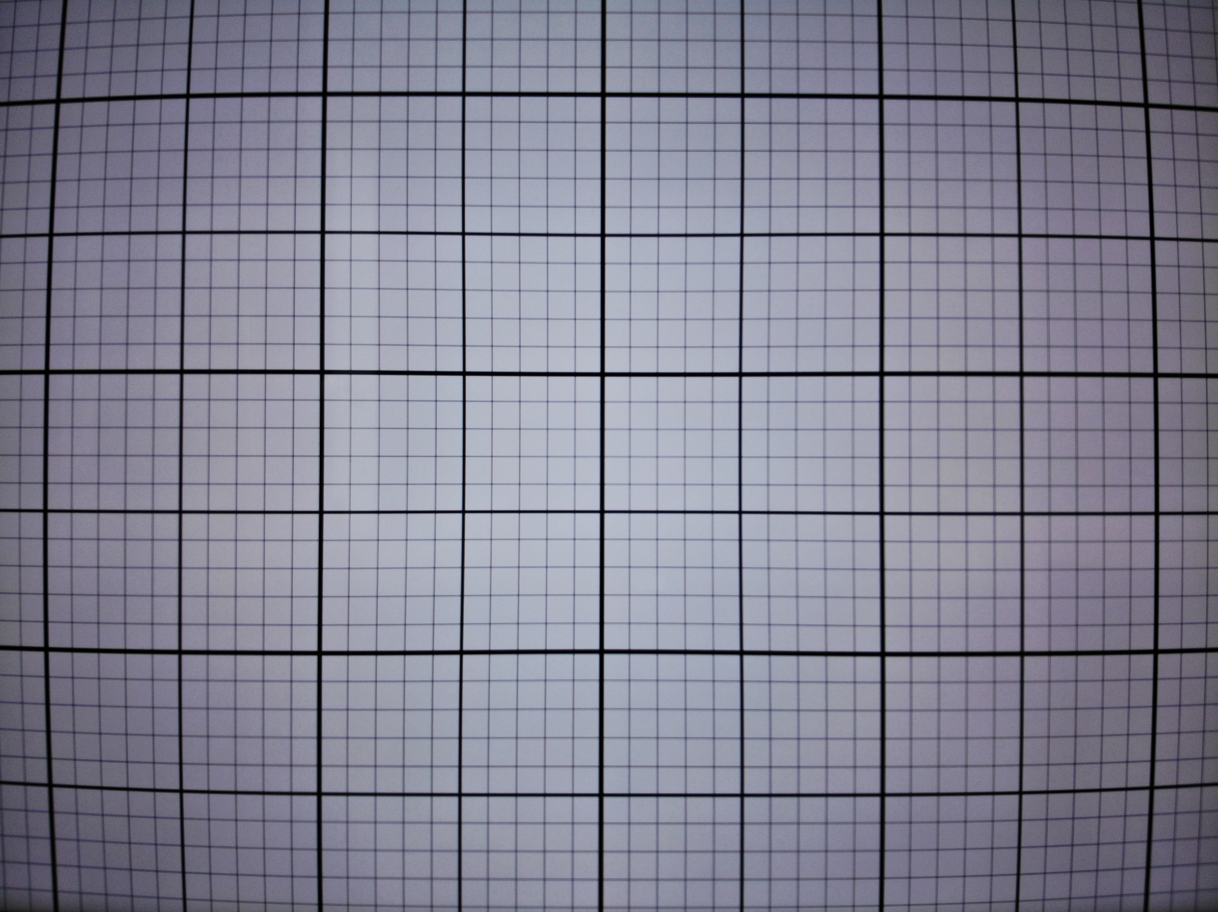

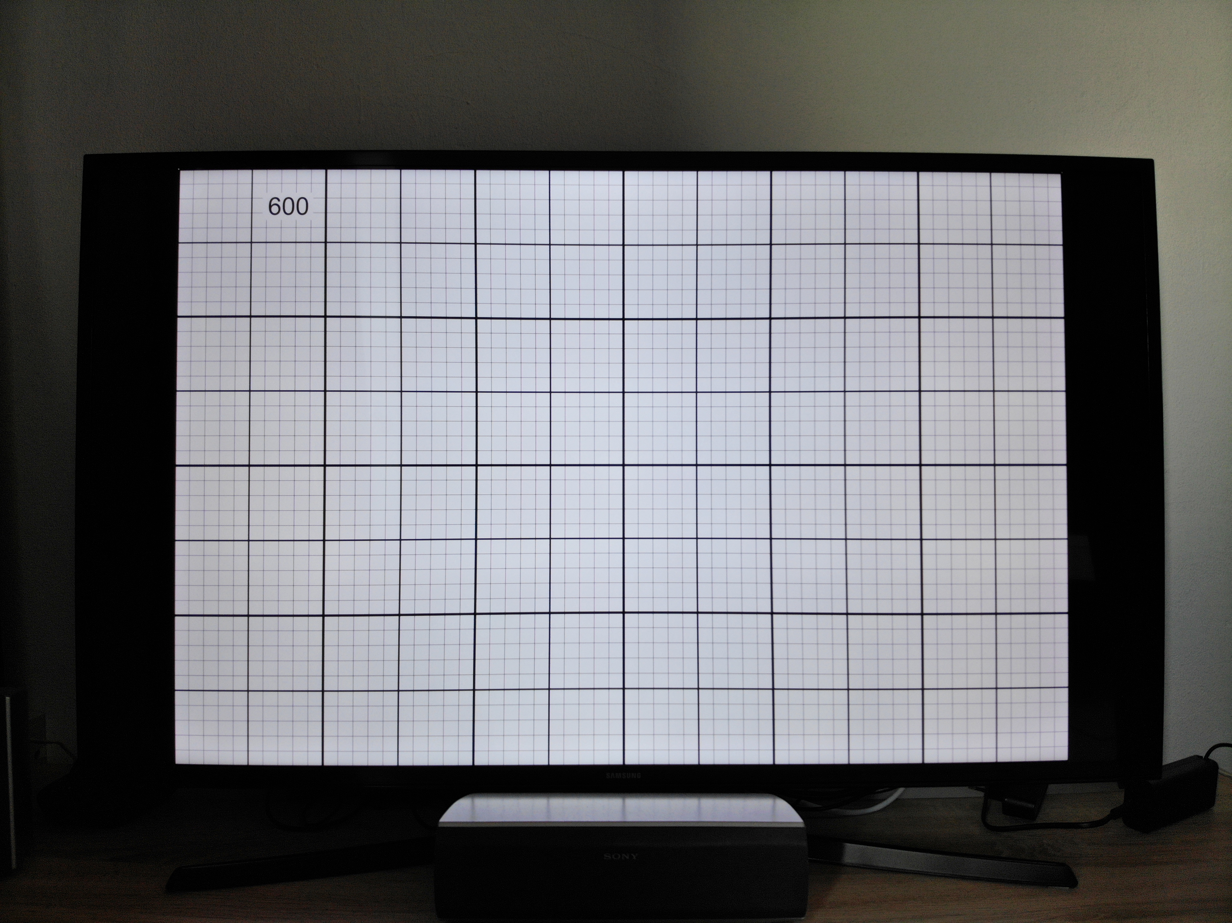

Did a quick test, and I have the same issue:
You can see the warping distortion very clearly in the roofs during the yawing motion. It's pretty bad, not happy about it...
That is exactly what I am seeing on my videos as well, I did some roof line shots at a distance (just to check I wasn't being obsessive about this) and see the warping of the roof line through/near the centre of the frame and it is very obvious when you pan.
Mine is going back and I am sticking with my Mavic Pro.
Reactions: ErikDF
The AIR has a 85deg FOV lens, slightly more than the Spark and significantly more than the Mavic. As someone said, this is the same issue which affects a GoPro or similar action cams with wide FOV. It can be fixed in software or in post, but it's not a faulty camera.
Are you talking about the general lens curvature towards the edges which is expected? I and others are talking about the near centre distortion causing wavy lines (not just curled up at the ends). That (for me at least) is not as expected!
