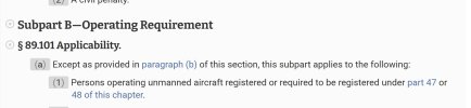

Is there an FAA source for that? The regulation says that RID is required if a drone is registered.
All Drones "Required" for registration must fly with RID. There is an exemption for recreational flyers under 250g, SO turning on the RID would be your choice really. If its "registered" you are still in compliance if your Flying for recreation without RID..The simple act of registering your Drone doesnt "tie" you down to always flying with RID...... unless the flights are commercial.
Reactions: mavic3usa
Well, I'd hate to see someone get into a bind over this. The regulation says otherwise: "registered or required to be registered" per the attachment in post #63. The FAA website states explicitly that registered drones flow for recreation are required to use RID.

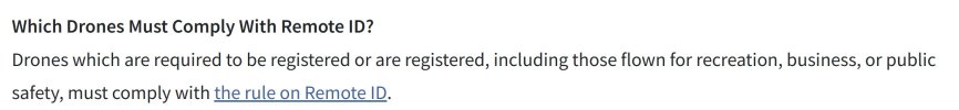

I'm just quoting the FAA. I'm not up for an argument, but they seem to disagree with you.
(italics added)
Which Drones Must Comply With Remote ID?
Drones which are required to be registered or are registered, including those flown for recreation, business, or public safety, must comply with the rule on Remote ID.

It says "comply with the rule."
It doesn't say "must transmit."
There's little difference for most of us.
Yes, you can be in compliance without transmitting RID if you have authorization from the Administrator of the FAA or fly in an FAA-recognized FRIA.
You can still comply with the rule by taking advantage of the exception which permits you to forgo transmitting.
Where is that described in the regs?
see my previous posts.
