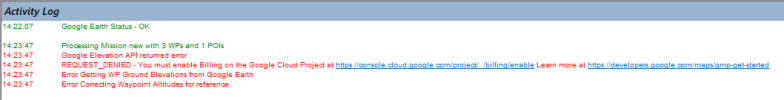

I use VLM often and have my own Google Elevation API key. The VLM elevation profile is empty for me whether I am using my own key or using the shared key. I don't think I've seen that work in years.
Wes, that might suggest in some obscure way it is a Windows issue not a Google or VLM. I have always had the profile show when using the Litchi key. As soon as I drop my own key into it, it isnt there and ten seconds leter I revert to Litchi key, and I have it..
Do you use windows ? I cant even imagine at this point a connection.
Reactions: RodPad
Yes, Windows 11. I remember, it used to sometimes work but I can't say long ago that was. Now, it does not work for me with or without my API key.
Reactions: RodPad
I too am Win 11 for whatever that might mean.
I find the Elevation profile gives me a first in level of elevation comfort, and a warning not to screw with gravity or big rocks/hills and relook safely at what I'm traversing or my Waypoint locations for what I want to do..
Is there another app or approach which will give me this same simple view ? Google Earth does to a point but without any level of security
Maybe Namirda can come in again and offer his wisdom ?
To add to RodPad's question about how often I plan a mission. I have a relatively light demand, say 1-3 missions a week and that involves a bit of adjustment and playing with the whole mission to get the video I want with the subsequent calls on the Elevation Key and GE. BUT the occasions when Namirda's key is over quota is probably 50% which means a lot of other fellas are using it too and sending it over limit. My going to my own key was to give me what I wanted when I wanted it - That might relieve the (small) load I had placed on the rest of the population.
Reactions: RodPad

I wonder why I never get notified when there are new posts on this thread? Does it work for others?
Just noticed the recent comments about the API key. A month or so ago I started getting unwelcome charges from Google due to the default API key used in VLM. It seems Google have drastically reduced the number of API calls which can be made for free - I was not aware of the changes and so it caught me unawares. As a result I have had to reduce the quota on the default API by about 90% which explains why you are maybe seeing the "Quota Exceeded" message more regularly.
The elevation profile window works for me all the time and I am just using the default key.
I have just checked the settings for my account in console.cloud.google.com and I see that "Maps Javascript API" is enabled as well as the expected "Maps Elevation API". I have no recollection of enabling it - perhaps it is the default.
There is quite some javascript used in VLM and so maybe the "Maps Javascript API" is required - I don't use it explicitly but Google are not always transparent about these things. It might be worth enabling "Maps Javascript API" in your account to see if it makes any difference.
If that doesn't help then perhaps somebody could take a look in the developer console in your browser next time you have a problem with the elevation profile window.
Google has changed their pricing model. I use a number of their services. They used to give you $200 credit per month. Now, it is a number of SKUs that are free. For example, you can only have 5000 elevation calls per month before you are charged. I've had to greatly reduce the quotas that I had set up.
For the past year or so mine has always said "No Profiles Available". I just figured it no longer works.
I use thee Maps Javascript API for a different project with a different key. For the key that I use with Litchi utilities I only have Maps Elevation API enabled. I can try enabling the Javascript API and see if that makes a difference.
Reactions: RodPad
I have tried setting my key to "unrestricted" so that it can use any API. No change.
I've tried looking at the developer console (gear icon). I don't see any errors. Is there something specific to look at?
I also tried resetting VLM (ctrl-click). No change.
Whether "Altitudes" or "Heading and Gimbal Angles" is selected, the bottom window pane displays "No Profiles Available".

The elevation profile is definitely working for me - see below.
It's not easy to debug a problem that I can't see. I'll look into it when I find some time.

Hi @namirda .. I trust you are well. (And hopefully get a notification. 🤞)
Not used in a while .. and a new (to me) Mavic Pro 2 has rekindled my interest.
But ..
How do I get things up and working again.
I have got as far as setting up Google project billing ... but my 80 year old brain has no idea what to do next.
TIA
If anyone else can help me get this working it would be much appreciated.
I really have zero idea what I need to do .. beyond the Google project billing stage.
You have to register in order to get a personnal API key you can enter in VLM.
But look at the Narmida's post, above.
Reactions: OzoneVibe
I have a page with a tutorial on how to set up the Google Elevation API and a section on enabling your "Google Billing Account". Once you go to the billing page, make sure you have a credit card on file under "Payment Method".
Done that bit .. then it's all a mystery.
I did .. but not enough detail for my brain and skills.
Ooo - cool - I'll take a look.
I got to the Google Billing bit .. and my registered credit card was used.
Thanks both!
OK - I have a key - and VLM is mainly working. Many thanks.
Initially I kept getting a strange ".. mission names must be alphanumeric .." which they are. But closing VLM and restarting seems to have solved that issue.
The only thing I'm missing is the altitudes profile .. which is probably the thing I've always used the most.
Strange - last time I used VLM .. and actually demonstrated to someone (around mid August with my Mavic Pro) .. the altitude profile was definitely working.
