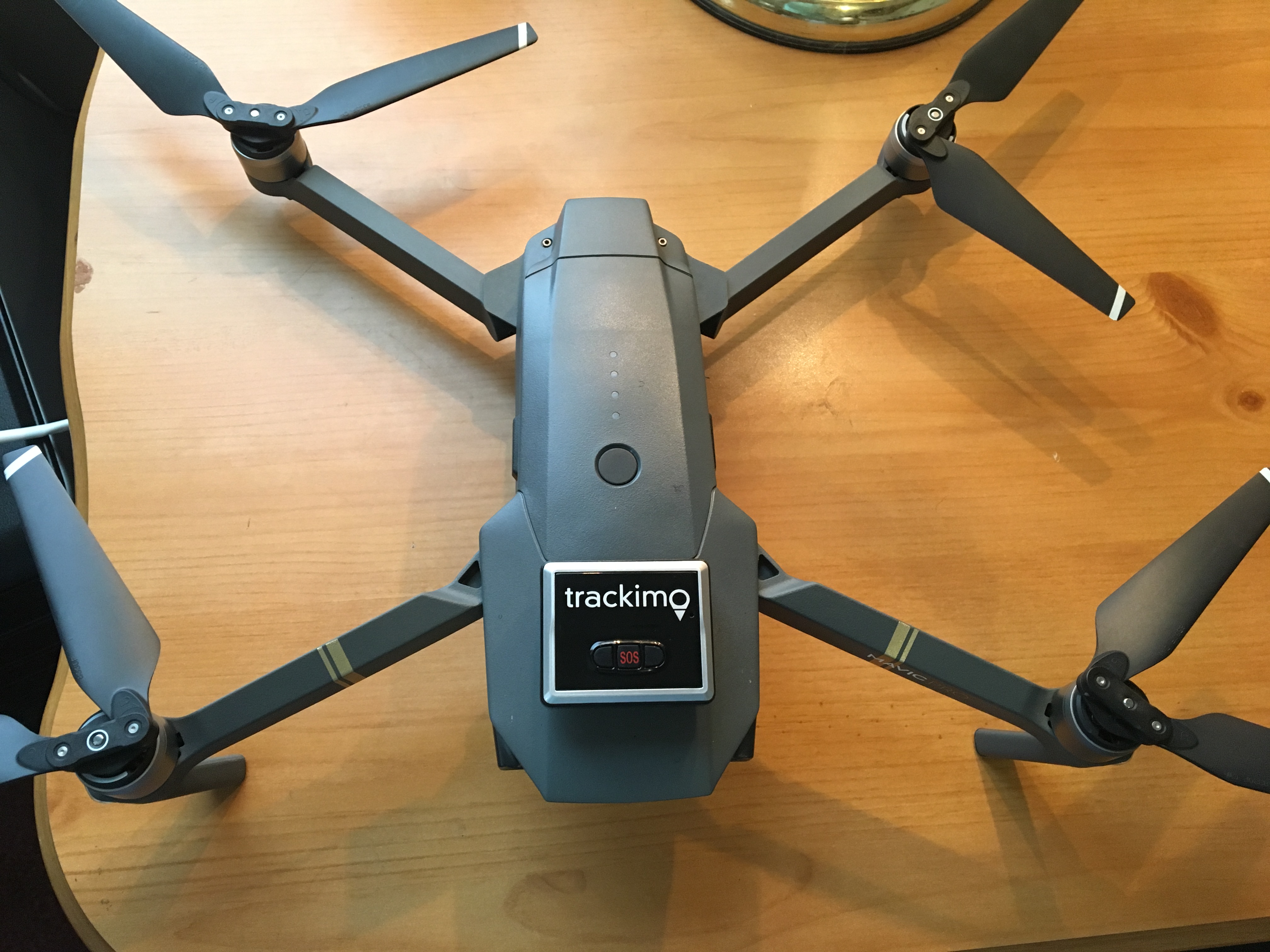

I have a Trackimo which uses GPS, 3G Phone towers and Blue tooth once you get close for the blue tooth to pick up on your phone.... Better option I think.. Trackimo® 3G GPS Tracker + 1 Year GSM + Free US Shipping
It is small, light weight and battery will last about 6 to 7 days... I fasten it on top front of my Mavic with valcro. Tracimo pic link on Mavic PIC #1 IMG_1489 PIC #2 https://mavicpilots.com/media/img_1488.1643/full?d=1519592718

Yep, but, if i go to the mountains, usually there is no 3g or sometimes any cell coverage in there, at all. There are still plenty of such places in VT, NH and upstate NY.
Thx for the info, i am looking at it now.
Looked, price wise it is pretty much same as that marcopolo thing. what makes it better? i am really not sure about bluetooth coverage distance, as in foreign country or with no coverage from cell towers it is pretty much the only signal left?
