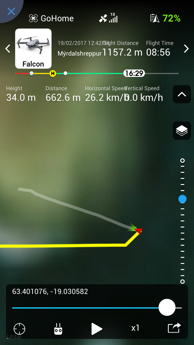

Thank you for this insight! I figured out why I had the impression that it "appeared" to have moved sideways. During the time it was disconnected, there was no telemetry going to my handset. Thus, the part of the flight that represents the termination of the Course Lock trajectory, and the initial phase of the RTH flight, was not included due to the 28 seconds of disconnection. However, the DJI GO app renders this as a connected yellow line, so it "seemed" to have moved sideways. This new analysis of yours puts the correct visualization to the data, and it makes sense. I would prefer if they just left it as a gap and not tried to "connect the dots" here with erroneous flight path.
Thank you!
Here is what I was looking at prior to having access to these logs and your expert help:
This created for me a false impression that it had moved sideways.
