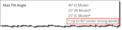

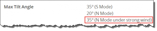

For instance my own MA1, the MA2 & the Mini 2 prioritize the maximum speed in slower modes than Sport. They allow the AC to utilize tilt angles into Sport mode territory in order to maintain the AC ground speed in head winds.
MA2:
Mini 2:
For my own MA1 DJI doesn't mention this ... but have noticed this behavior during my flights in headwinds.
MA2:
Mini 2:
