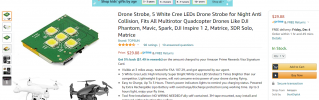

The TOPSUN lights are currently showing as in stock here on Amazon.
I clicked on the link you provided and was redirected to the product shown below.
I actually had the Topsun listed in my previous orders as I had ordered it and canceled it before it arrived, but when I click on it I get the "Sorry" message. A search on Amazon provided the results in the last screen shot.

I tried ordering the TOPSUN on Amazon just the other day. I was notified of a later delivery than originally given, but when it was finally supposed to be delivered, I got notified that it could not be delivered and was returned to the manufacturer? Anyone have any clues to this? No reason why it could not be delivered to my house. I get deliveries from Amazon all the time. It still shows its available, but mine went back without being delivered to me.

Do you have a mount for the TOPSUN? I finally got it delivered, but I dont see a good place to mount it on my Pro platinum. On one of the Arms would be the best bet. Its a lot bigger than I anticipated, and the pictures on the sale page shows in mounting to the front of the Mavic, but its just too big.
Any suggestions?

The topsun mentioned in the above post are far brighter than any of the others.
It (the ad) does not give any specs on the brightness (lumens) that always scares me, if they're so good why don't they list it?
