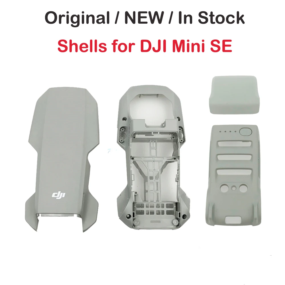

I recently was messing around with all the features the mini 2 has and used the spiral I had the idea that it sensed whenever near something it ended up crashing and got cracked on top everything else is fine thankfully. I do have insurance but wonder if it’s worth using the insurance or just buying a new shell? What do you guys suggest?

I would buy a new shell.

@aaronperez321 if you attempt any sort of repair yourself ,be it a new shell or some sort of glue repair it will invalidate the care refresh package ,all drones have certain,fixings screws that have a glue plug in the head of the screw to show if the drone has been opened, the mini also has a sticker just inside the battery compartment that seals between the two parts of the main body of the drone and this has to be removed or cut to get the body apart although the drone appears to be working ok an impact that would cause that amount of damage to the shell could have also done damage inside as well ,personally i would use my care refresh to get a replacement drone

Just get the shell. Is inexpensive. $12.99
