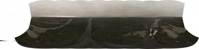

Are you sure? PanoramaStudio 3 Pro loads DNG's just fine for me. Stitched your files just fine.
Panorama Stitcher and Affinity Photo stitched it fine too. Lightroom messed it up for me, not sure why.
I stand corrected. PanoramaStudio 3 Pro loads them just fine is what I should have said but when you go to save the final rnder there is no option to save as a DNG so you can later edit it in Photoshop or Lightroom. Highest resolution I see is a TIFF.
I tried with Affinity Photo and the final photo was not a 360 photo. This is what I got from that.
