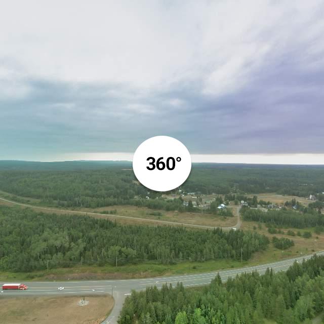

Yes ... that's how it works.
Like this:
Like this:
That's an interesting example - so you just fed a planar 360° pano to the Skypixel website. It has certainly made a decent attempt to convert planar to a spherical projection, but going via a planar projection does have clear disadvantages over the direct construction of a spherical projection from the individual tiles, in terms of image distortion.

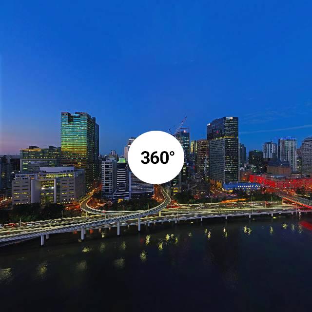

That's the standard method for lots of 360 sites.
Here's one that displays better:
That's a beautiful pano. But notice the image distortion as you pan it up and down - the buildings get taller as you look down and they move up in the field of view. That doesn't happen in a spherical projection, such as the one on the webpage I linked above, and is an artifact of converting a planar projection back to a spherical one.
I believe you’re seeing a player artifact, not a problem with the stitch.
Any flat view of a spherical pano wider than about 110-deg can look like that. If you zoom in a little on Meta4’s Kuula image it straightens out.
